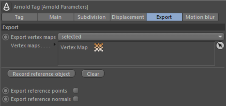

By default, all vertex maps of an object are exported to Arnold. To specify only a subset of the vertex maps or completely disable vertex map export, you have to add an Arnold tag to the object and change settings on the Export tab.

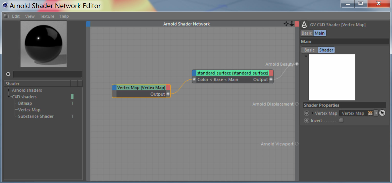

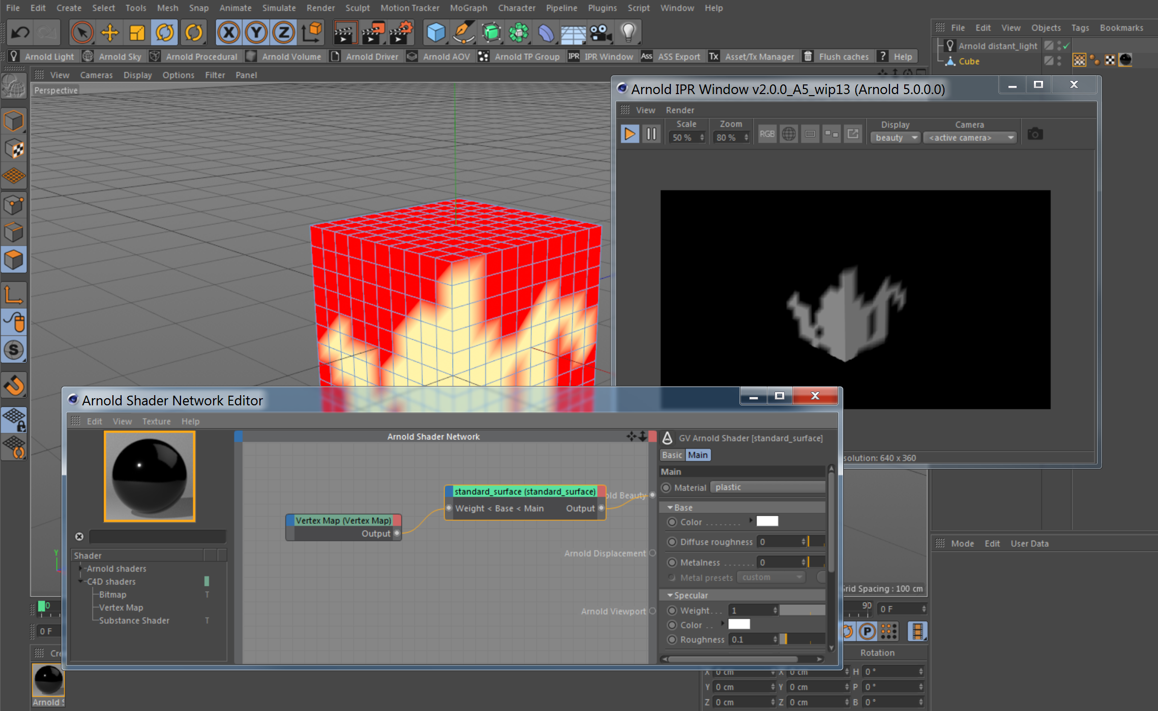

Vertex map connected to standard_surface Base weight.
Multiple vertex maps connected using the mix shader.
