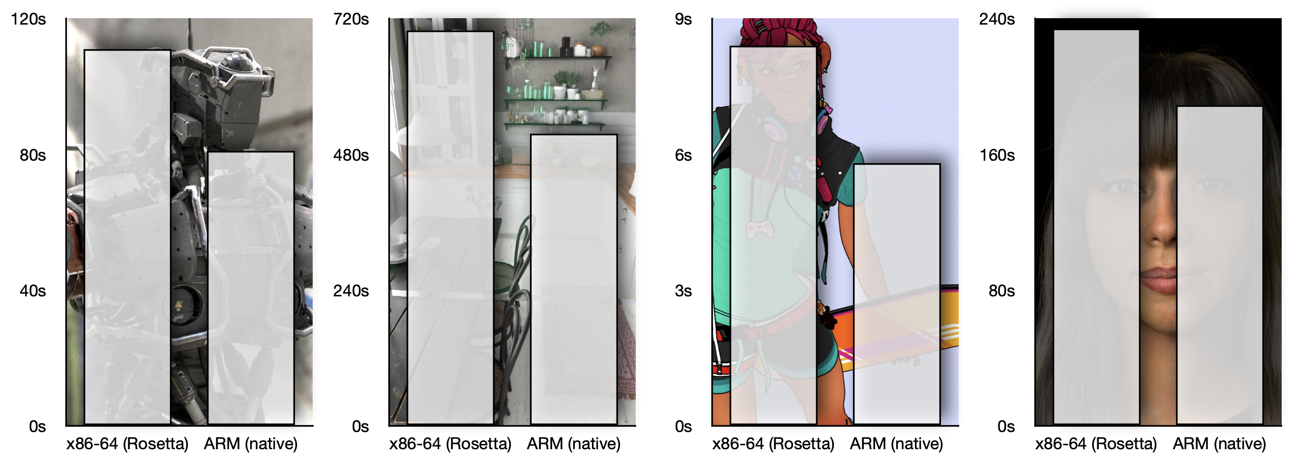

Apple Native CPU support: Arnold natively supports running under Apple M series CPUs, such as the M1 CPUs. Our tests give speedups of up to 1.45x compared to running with x86_64 Rosetta 2 translation (ARNOLD-10481, C4DTOA-2317)

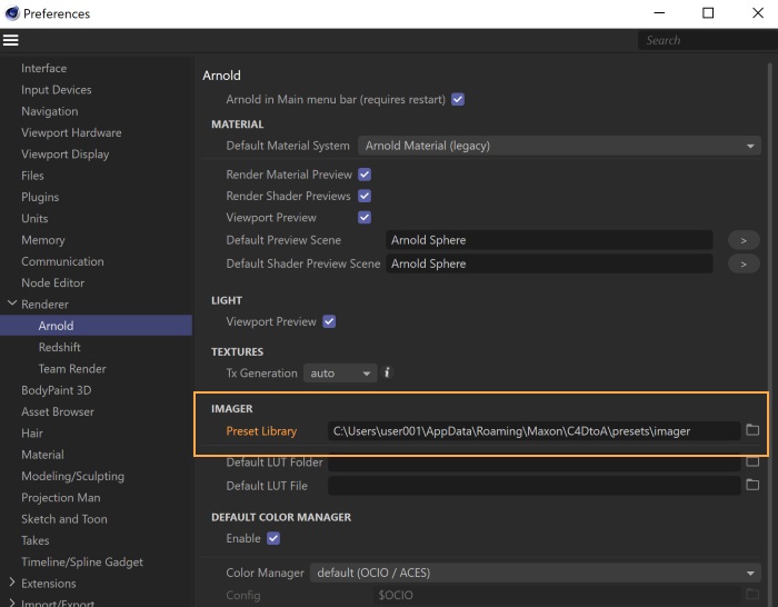

Imager presets: Presets of imager graphs and individual imagers can now be saved from the IPR window. Presets are stored in a selected preset library folder, which can be configured in the Preferences. Imager graph presets can be shared between Maya and Cinema 4D, support for other DCCs is planned in future releases. (C4DTOA-2175)
| Imager graph preset menu in the IPR window | Presets tab of an imager node |
| Imager preset library path in the Preferences |

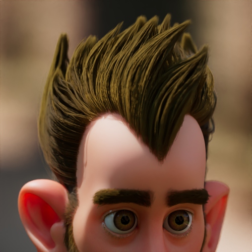

Hair melanin and redness: The standard_hair shader's melanin and melanin_redness parameters as well as the AidEonBSDF() function's absorption parameter are now being referenced in a linear sRGB color space so that the direct lighting results match when switching to other rendering color spaces such as ACEScg. The melanin_redness parameter will also now produce a more correct-looking red tint in ACEScg. (ARNOLD-7585).

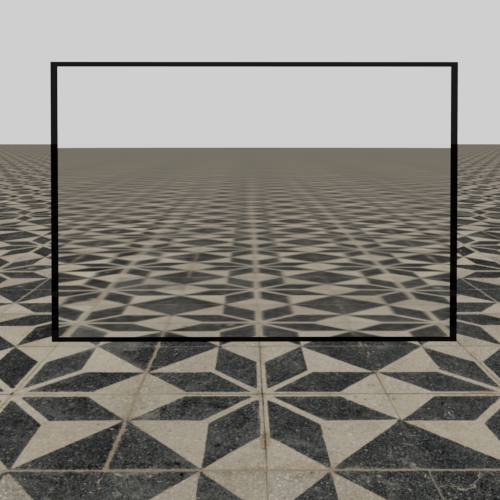

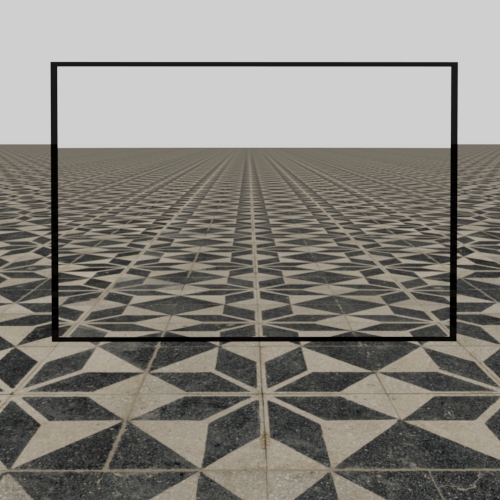

Sharp textures through reflections and refractions: Textures seen through specular reflections and refractions, particularly when there is low roughness, such as with clear windows and mirrors should now look correctly sharper. This can result in higher resolution texture mipmap levels being loaded in memory, so scenes that were affected by this can see an increase in texture cache usage. (ARNOLD-5632)

Hair melanin and redness in ACEScg: The changes to standard_hair shader's melanin and melanin_redness in ACEScg are potentially look-breaking. The absorption parameter for the AidEonBSDF() is now expected to be in a linear sRGB color space. Those changes can be reverted through the enable_deprecated_hair_absorption render option. (ARNOLD-7585)

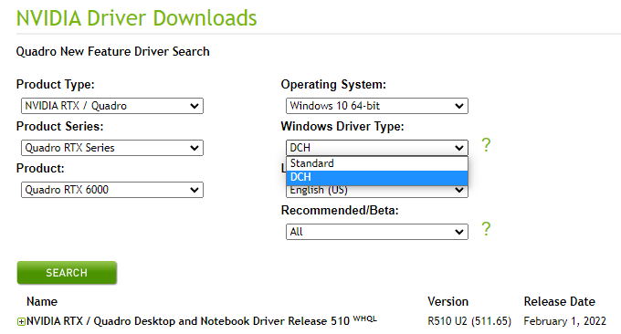

The driver type must be set to DCH.
In the driver page, select "Windows Driver Type:" DCH
The cache also needs to be re-populated after installing a new Arnold version, updating to a new NVIDIA driver , or changing the hardware configuration of GPUs on the system. More information can be found here .
