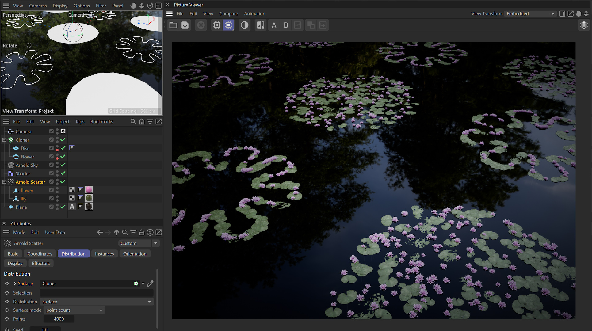

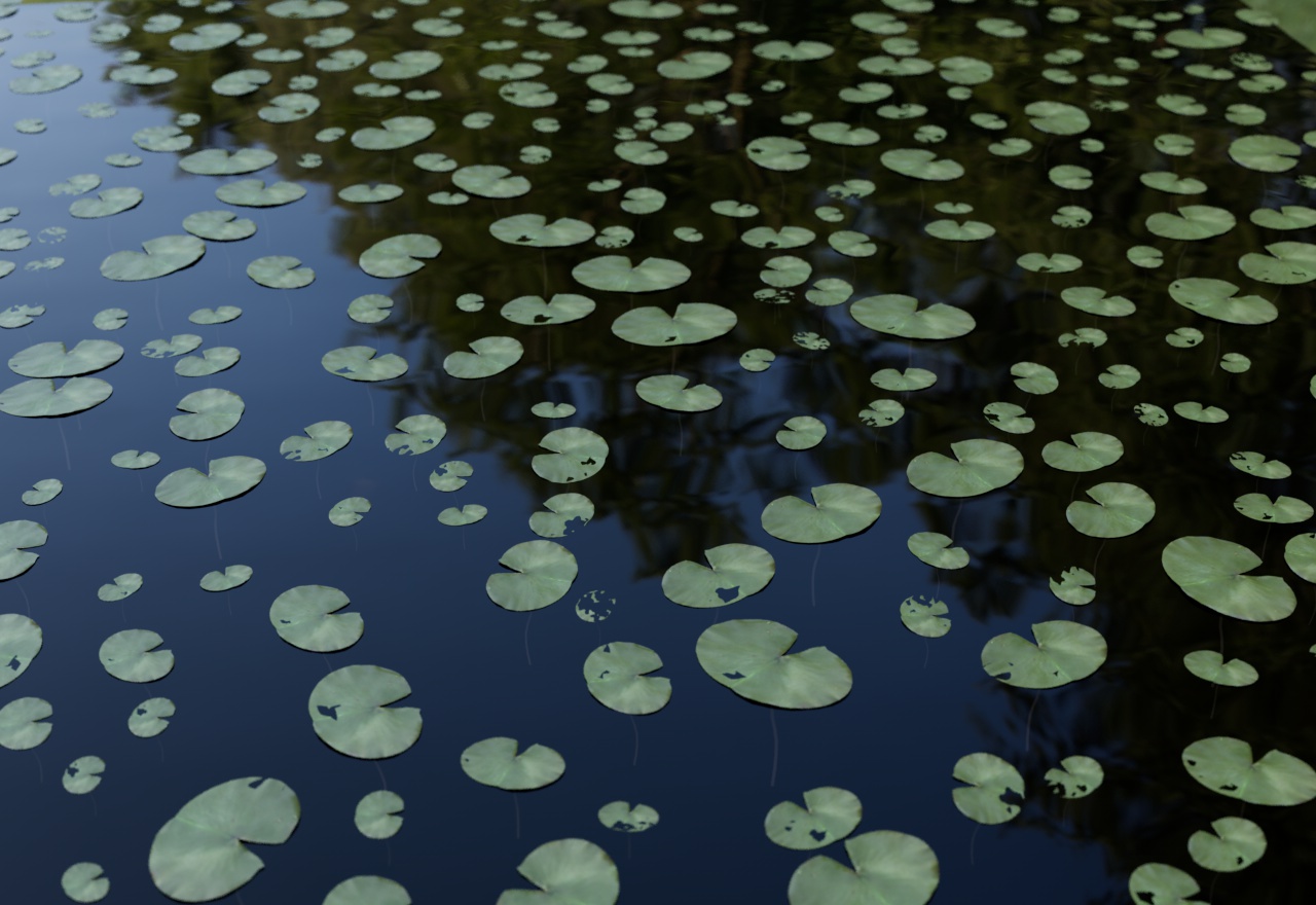

Lily & flower objects scatterd over a Flower spline object
Lily & flower objects scatterd over multiple Disc and Spline objects distributed by a Cloner

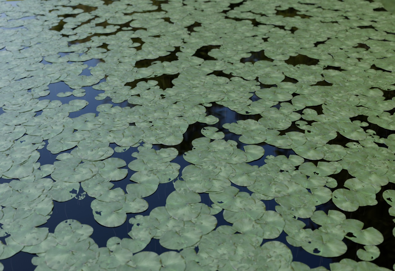

| Lilies scattered over a plane surface, push apart turned off. | Lilies scattered over a plane surface, push apart turned on. |
Arnold Scatter viewport display: You can now select the color of instances displayed in the viewport, whether it is the final color, the Display Color of source shapes or the Display Color of the Arnold Scatter object. (C4DTOA-3185)

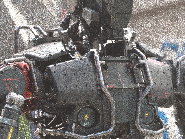

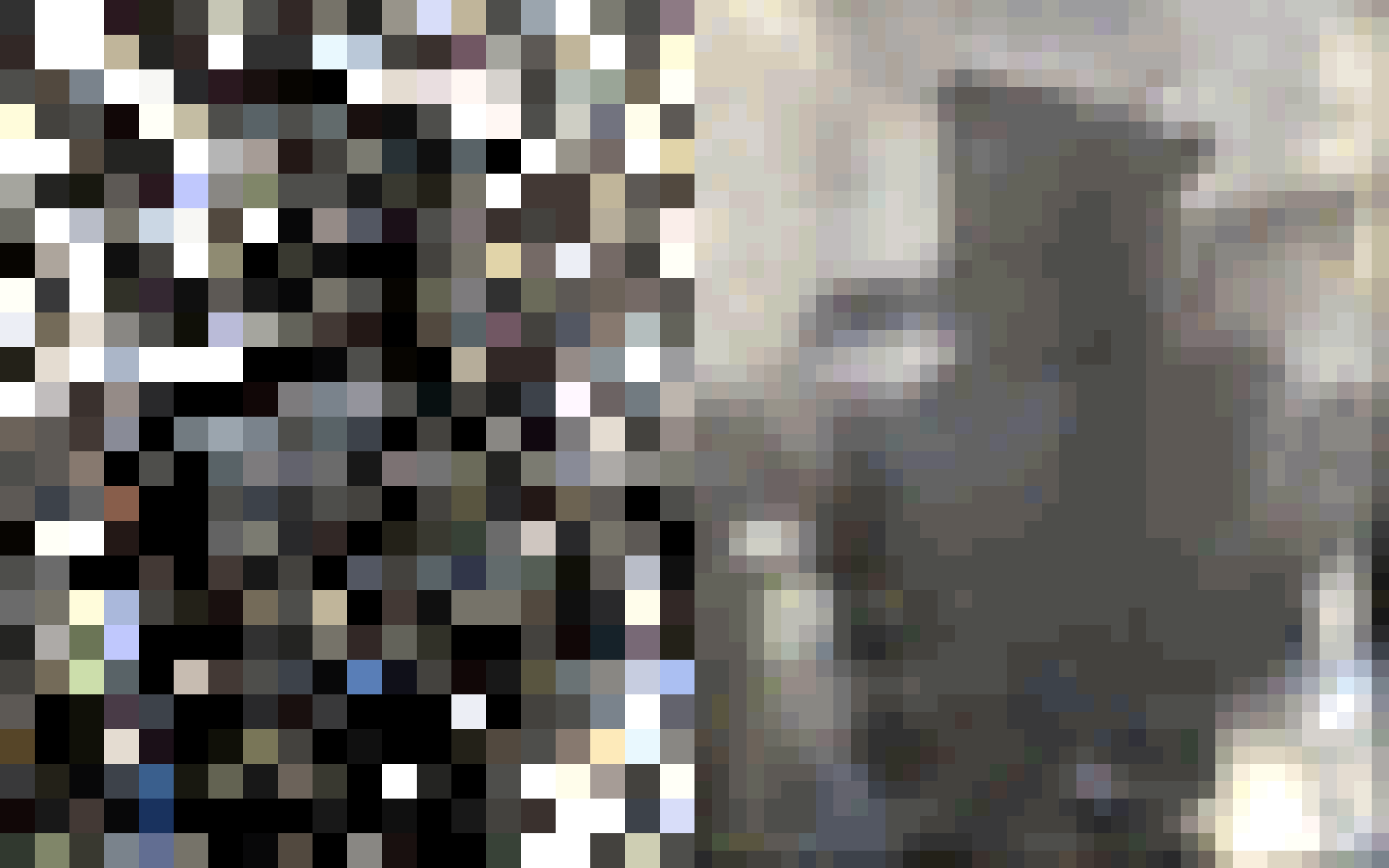

Enable denoising in new scenes: When selecting Arnold as the active renderer, an Intel ® Open Image Denoiser imager (OIDN) is now automatically created and added to the scene, thus you render with denoising enabled. Automatic denoising can be turned off from the Preferences. (C4DTOA-3151)
| without denoising | with imager_denoiser_oidn |
| Automatic denoising can be turned off from the Preferences |

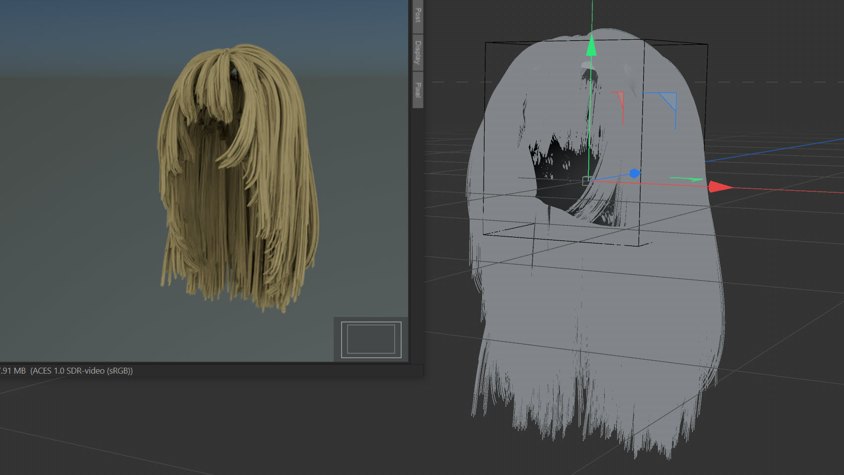

| Curves in viewport |

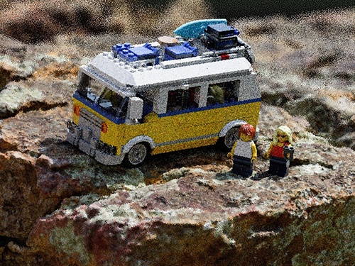

Progressive dithered sampling: Arnold now supports dithered samples in progressive and adaptive rendering. Dithering brings nicer noise distributions at low AA sample counts. (ARNOLD-10739)
| before 7.3.0.0, AA=1 | 7.3.0.0, AA=1 |

Arnold Scatter push apart: Push apart algorithm in Arnold Scatter has been changed and it is now executed after calculating transformation and executing Effectors. That means old scenes which has Push Apart enabled will now look different. (C4DTOA-3174)
