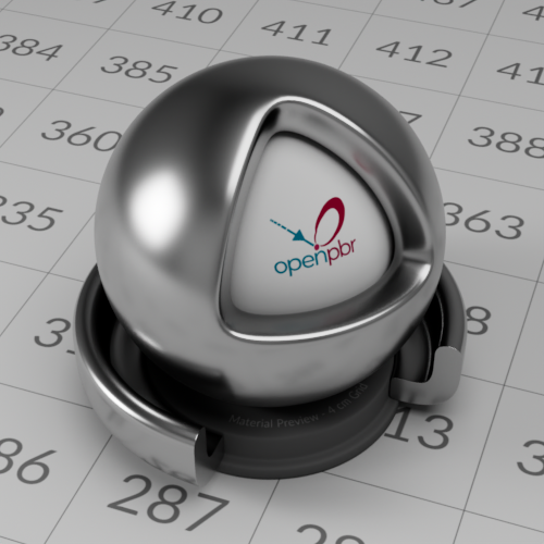

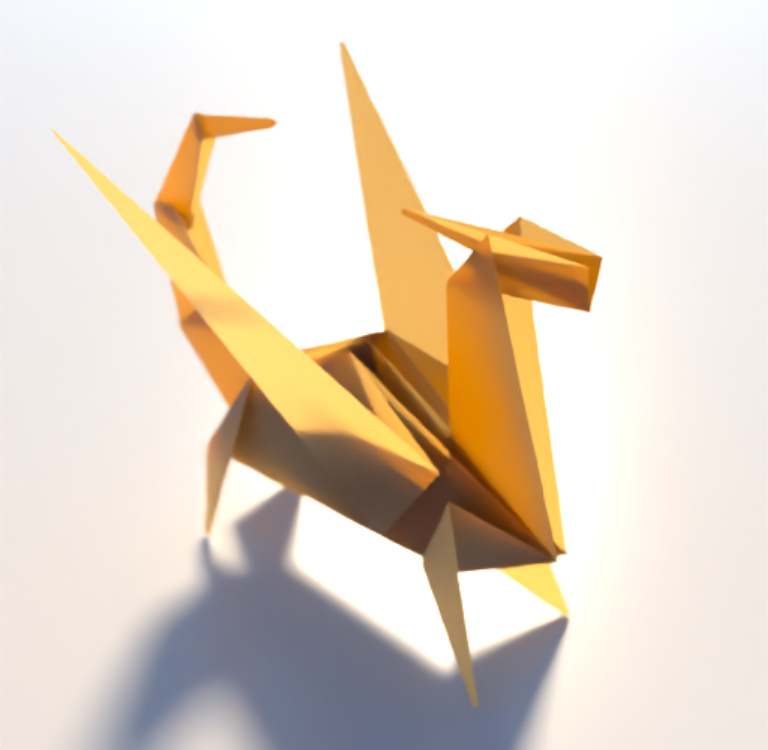

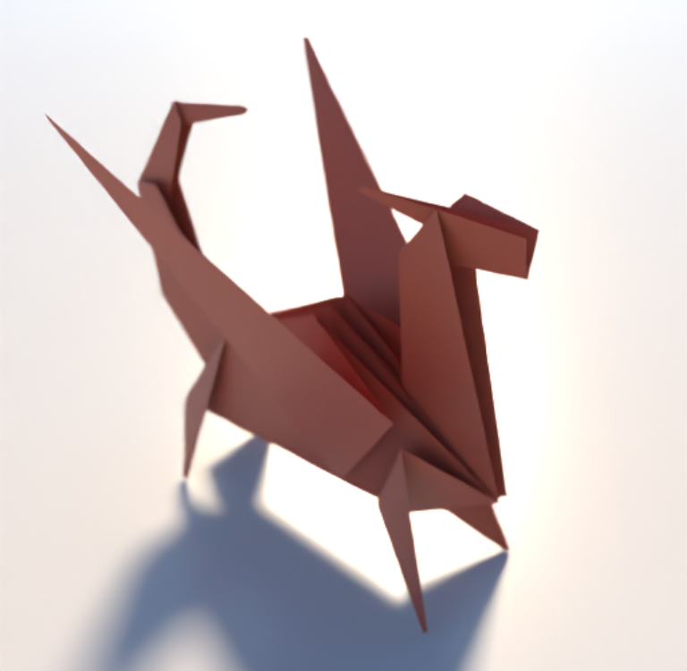

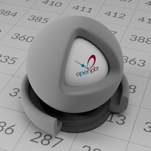

subsurface_weight to blend between diffuse and subsurface lobes while maintaining energy conservation. You can use this, for example, to model diffuse transmission and reflection in paper. (ARNOLD-15982)| previous behavior | ![]() |
| 7.4.3 | ![]() |
| 0 | 0.01 | 0.5 | 1 |

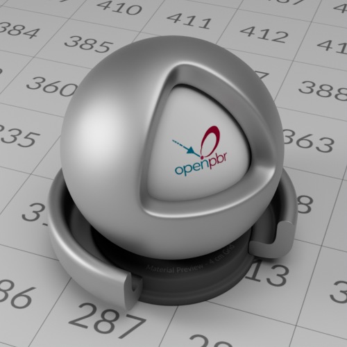

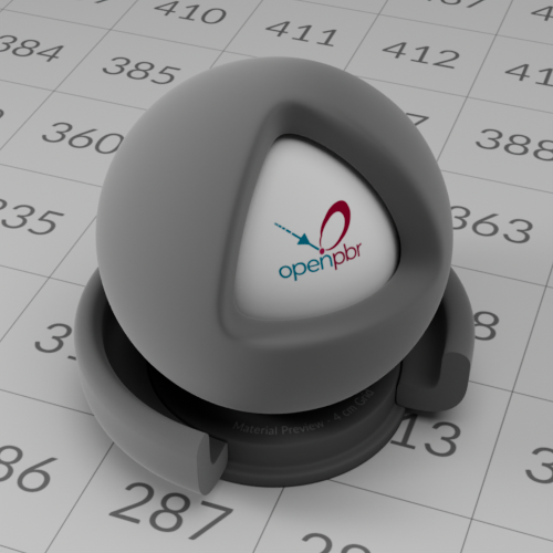

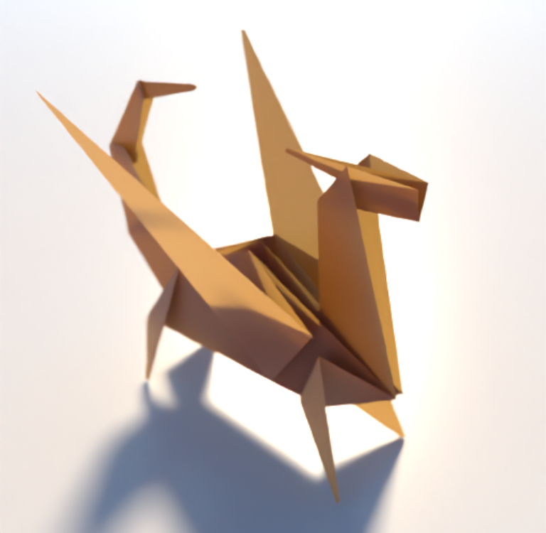

| 7.4.3 | ![]() |
| 0.25 | 0.5 | 1 |
