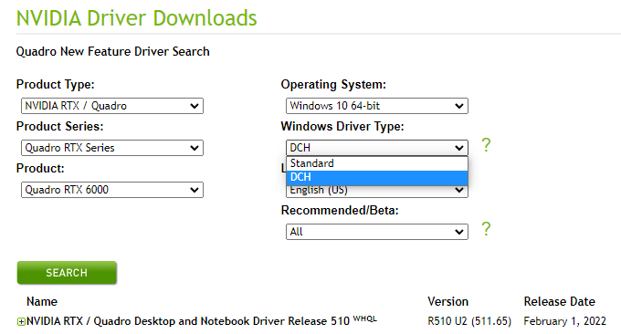

GPU rendering works on Windows and Linux only and requires an NVIDIA GPU of the Ampere, Turing, Volta, Pascal, or Maxwell architecture.
In the driver page, select "Windows Driver Type:" DCH
The cache will also need to be re-populated after installing a new Arnold version, updating to a new NVIDIA driver , or changing the hardware configuration of GPUs on the system. More information can be found here .
