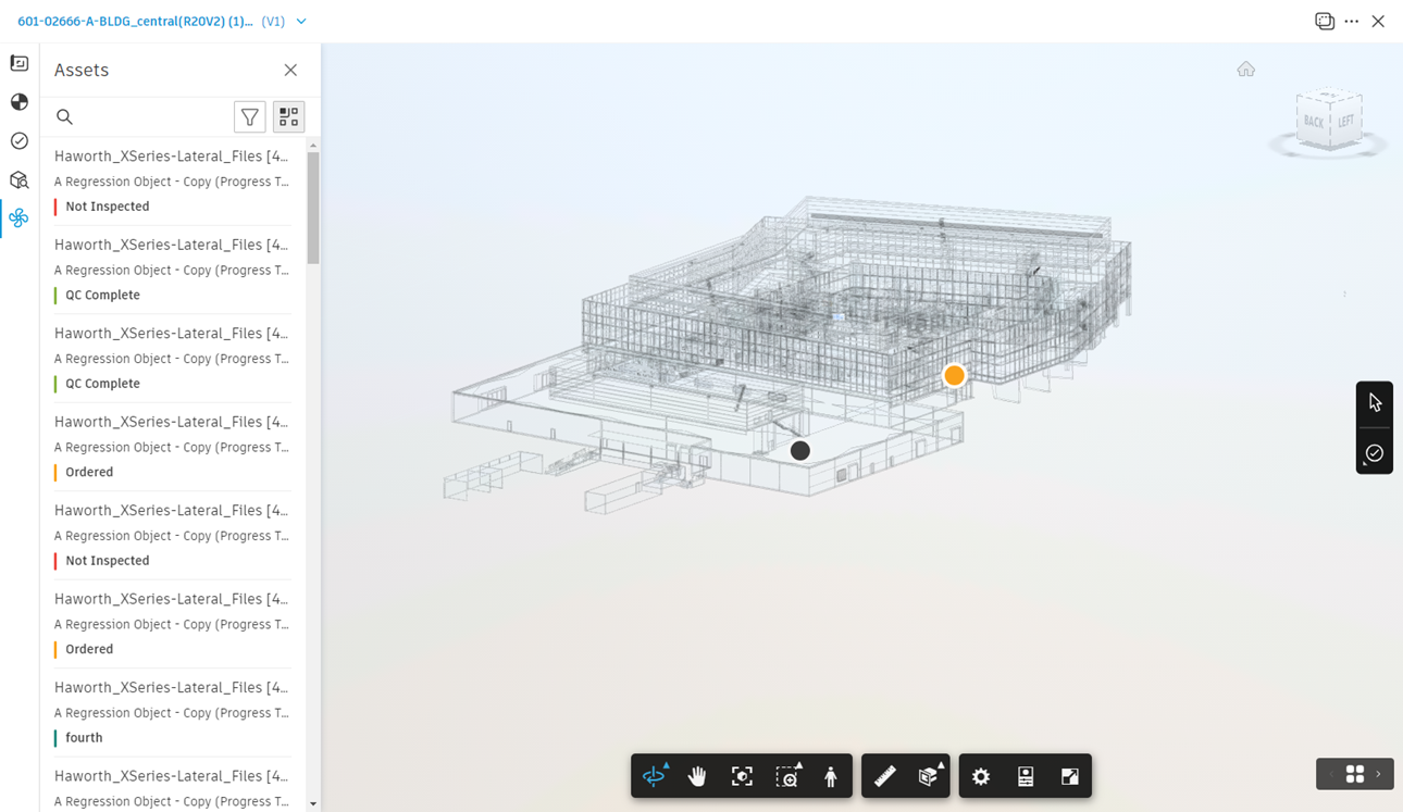

  2. Click the Assets tab on the left navigation.
    The Assets panel opens and displays a list of all the assets in the model you have selected. The assets in the model become colourised based on their status.
  3. In the panel, you can:
    • Search Search – search assets by name.
    • Filter Filter – select from the drop-down lists to filter the assets by status, location, category, systems or custom fields, and then click Done.
      Your asset list updates accordingly, and the assets that don't match the filter criteria become transparent in the model.
    • Isolate assets Isolate – select this option to make any components not identified as assets transparent in the model. Click again to show all components.

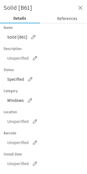

  4. Select an asset from the list or from the model. The asset is highlighted in the panel and the model, and its details appear in a panel on the right.
    Tip: If you select an asset in the model but don't see the details in the panel on the right, use the Viewing toolbar > Settings option > Configuration tab to change your Selection Mode. You can choose from Leaf Object, First Object and Last Object to enable selection of objects at different levels of the model.
  5. Click into any field to edit asset information or update its status.

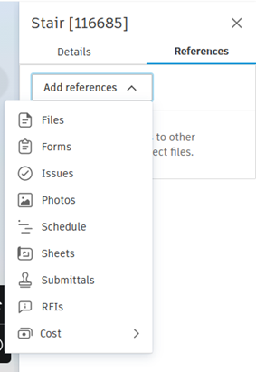

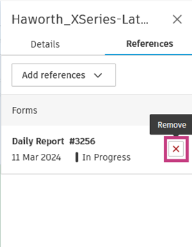

  6. Switch to the References tab to add and remove references. You can add photos, videos, forms, issues, submittals and other references to an asset to connect all relevant information to an asset.
    1. To add, click Add references. Select any of the project items from the list and add accordingly.
    2. To remove, hover over the reference and click x.
