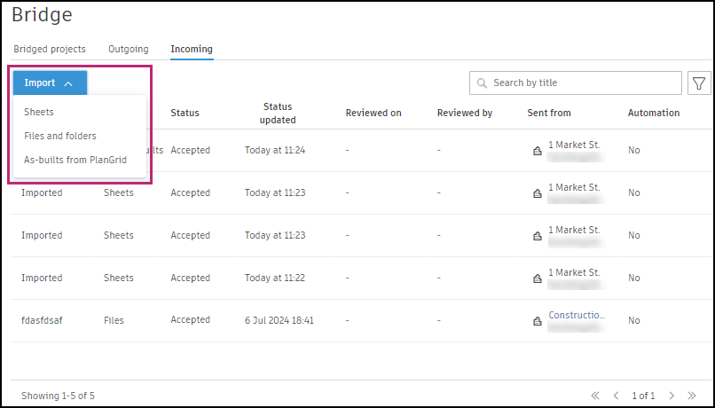

  1. In Forma Data Management or Forma Build, navigate to the Bridge tool using the left navigation menu.
  2. Select the Incoming tab.
  3. Click Import and select As-builts from PlanGrid.

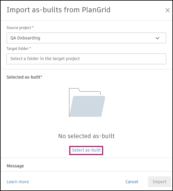

  6. Click Select as-built.
    Note: If you don't have any as-builts in the selected source project, the list will be empty and there will be a link to Go to project in PlanGrid to go directly to the PlanGrid project and create as-builts.
    Select as-built interface
  7. Select an as-built from the list.
  8. Click Select.

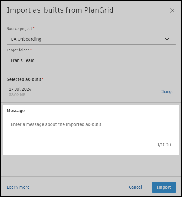

  9. (Optional) You can enter a message about the imported as-built to provide context for your project members.
    Message import as-built interface
  10. Click Import.
The as-built from PlanGrid will appear in the Files tool in the target folder that you selected. Project administrators will receive an email notification when the as-builts are ready. A record of this import will appear in the Incoming tab.
