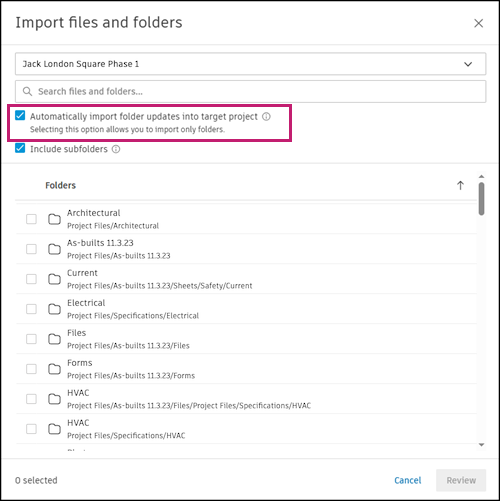

  3. Click Import and select Files and folders.
    Import files and folders interfaceImport files and folders interface
  4. Select a project to import files or folders from.
  5. Use the search field to search for files or folders by name.
  6. (Optional) Select Automatically import folder updates into target project to create a folder automation. In a folder automation, when updates are made to the selected folders in the source project, the target project will receive the updates. This feature is useful for making sure that the stakeholders you shared the folders with will always automatically have the most updated files.

    Import files and folders dialogImport files and folders dialog
  7. (Optional) Include subfolders will be selected by default. All subfolders within the selected folders will be shared. You can deselect this option if you want only to share the parent folders you select.
  8. Select files or folders that you want to share.
