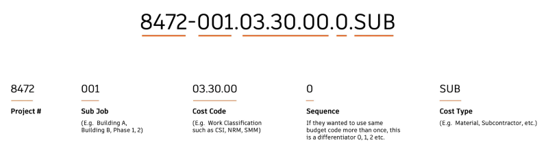

Here is an example of a real budget code:
Example of a budget code showing segment structure with code format and preview

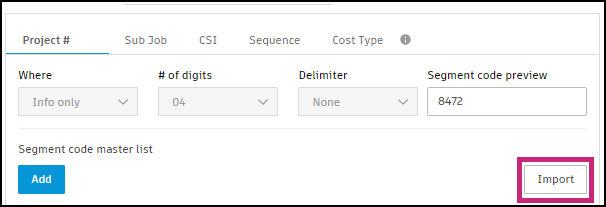

  1. Click Import in the Segment Code Master List section.
    Import button in the Segment Code Master List section
  2. Click Download Template.

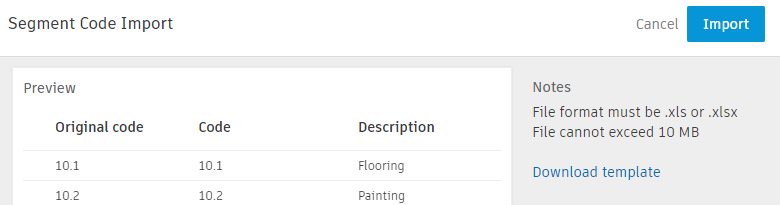

  4. Choose your saved file or drag it into the Segment Code Import window.
  5. Click Import.
    Import button in the Segment Code Import dialog window
  6. Click Done.

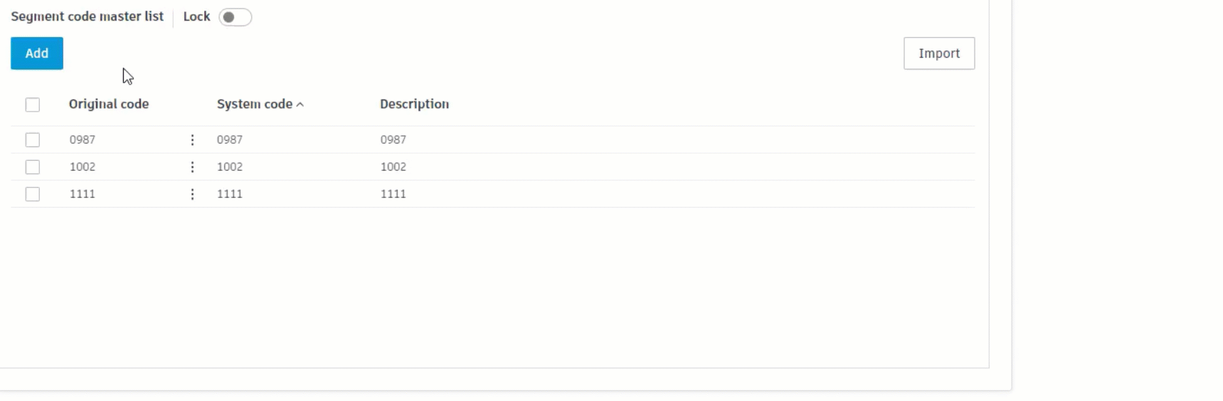

Edit a Segment Code Master List - Add a Hierarchy Example Scenario
You can edit an already defined and imported budget segment master list, for example, to add a hierarchy. You can add a group summary section as a hierarchy item.
To create a hierarchy item:
  1. Go to Settings from the left navigation.
  2. Switch to the Budget tab.
  3. Scroll down to the Budget code format drop-down section.
  4. Click Add. For this scenario, a new group hierarchy item 26 has been added.
  5. Select all the items that you would like to be moved under the new group item 26. You can do this by using the Shift key to select a range of items.
  6. Select Move and select the new target parent item 26.
  7. Click Save. All items are now moved under new group item 26 that was created.
Animation showing how to add hierarchy items to segment code master list by creating and moving items under a parent group
A new hierarchy level for viewing and reporting in the Budget view is now visible.
