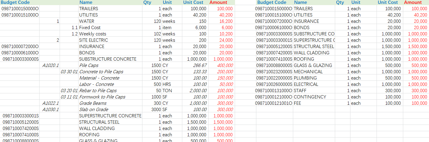

Best Practices on Formatting a Budget Excel File
The following example shows an exported budget on the left and the proper format for import on the right. The summary groups are removed, which allows sorting by segment – the same functionality, but more flexibility.
Budget import example showing exported budget on left and proper import format on right
Tip: Follow guidelines within budget template to see more tips and tricks.

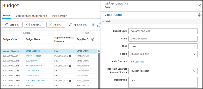

  5. If desired, you can click on the budget name to open the details panel and add a description for the budget code or change the budget name.

Tip: You can quickly edit budget items by clicking on each one and using the panel on the right.
Budget details panel on the right side of the screen showing budget item information

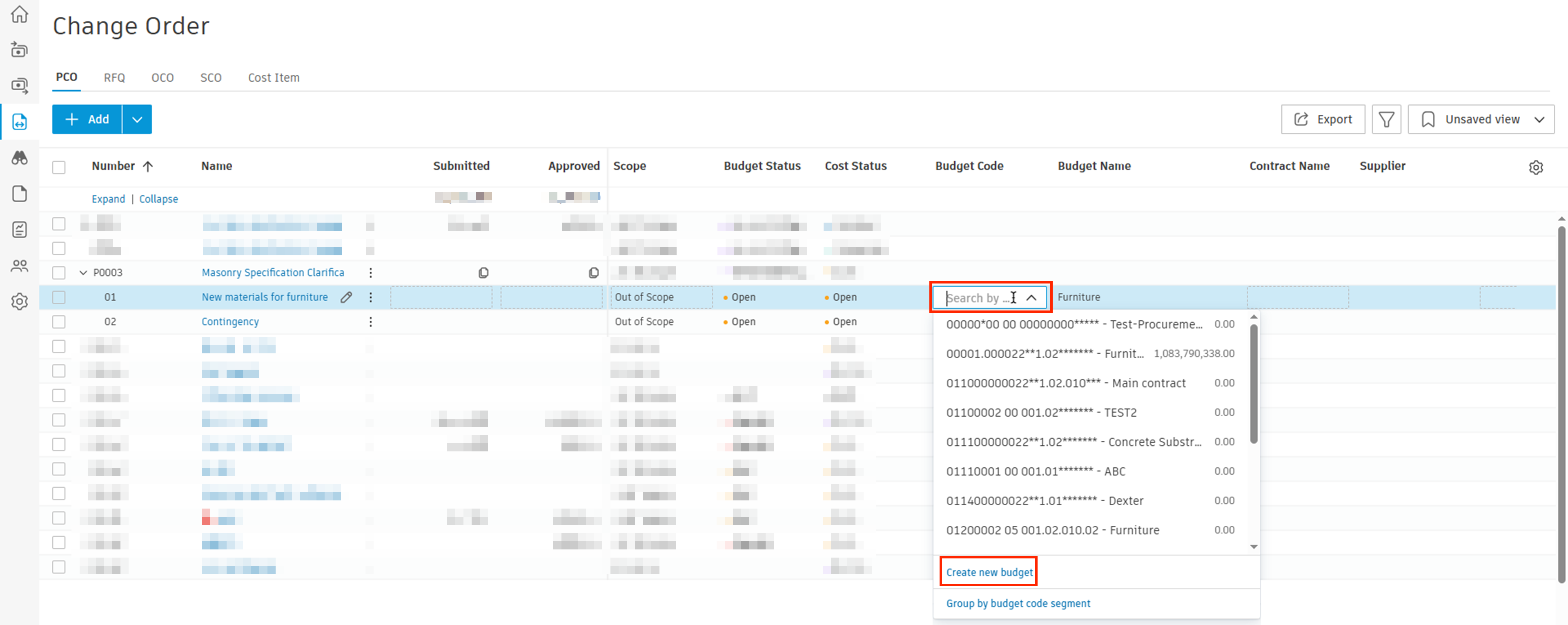

Add a Budget from a Cost Item
When working with cost items, you can create a new budget directly from the cost item's budget drop-down. This method is convenient when you're in the process of creating or editing a cost item and realise you need a budget that doesn't exist yet.
To add a budget from a cost item:
  1. Navigate to the Change Order tool from the left navigation.
  2. Switch to the Cost Item tab.
  3. When adding or editing a cost item, click the Budget Code drop-down.
  4. Select the option to Create new budget from the drop-down.
  5. Follow the prompts to define the new budget with the appropriate budget code, name and other details.
Cost item budget drop-down showing option to create a new budget
Once created, the new budget will be automatically selected for your cost item and will be available for use in other cost items and throughout Cost Management.

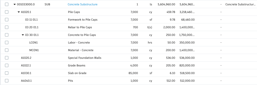

Add a Subitem to a Budget
Within each budget line item, you can add subitems that contribute to the total of the parent budget item. For instance, if you have a budget line item for the concrete substructure, you can further break it down into subitems such as pile caps, labour and slab on gradient.
Budget hierarchy showing parent budget item with subitems for pile caps, labour and slab on grade
To add a subitem:
  1. Click Pencil icon to open the budget in Edit mode.
  2. Enable the tick box for a budget item. This becomes the parent.
  3. Click the More menu Vertical three-dot menu icon on the parent budget item.
    Tip: You can also right-click on the budget item to bring up the More menu.
  4. Choose Add Subitem.
  5. Follow steps 4–8 in the Add a Budget to fill out the budget code, budget name, quantity, unit and unit cost.
  6. Click Pencil icon again to return to the default view-only state.
