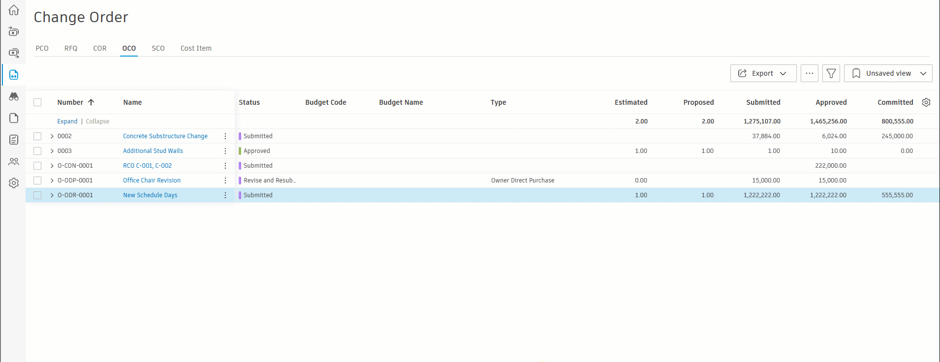

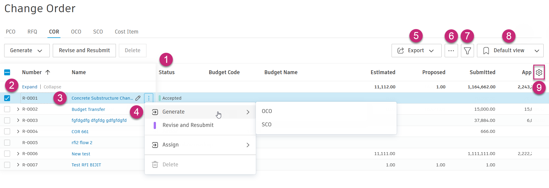

Change Order Tabs Overview
The COR, OCO, and SCO tabs all function similarly within Cost Management, with only small differences. Tab names can be customized by project administrators within settings.
Change order tabs overview
  1. The item's status automatically updates to Draft after a change order is generated from a PCO. See the Change Order Statuses article to learn more about change order management statuses.
  2. Tick the box next to one or more change orders to change the status, generate the next change order or delete a change order.
  3. Select the item’s name to open the flyout panel. In the flyout panel, selectable workflow-based actions will appear to guide you through the change order management process.
    Workflow actions in change orders
    For example:
    • When the COR status is Submitted, Set as Accepted and Set as Rejected buttons are visible.
    • By selecting Set as Accepted, the status colour changes, and the next options are Set as Rejected, Generate and Revert to Submitted.
    • With the status Accepted, an OCO or an SCO can be generated.
  4. Click the More menu Vertical more menu icon to set the status of the change order, generate or assign a change order, add markup or recalculate one, or delete the item.
  5. Click Export to create a change order report.
  6. Click this icon to show or hide change orders' hierarchy. To learn more about using the hierarchy view to navigate between related change orders, see the Navigating Change Orders with Hierarchy View section.
  7. Click the Filter icon to filter and group the table.
  8. See the available predefined views of the table or save the current view of the table.
  9. Select the Gear icon for column settings icon to edit the position and visibility of columns within the table.

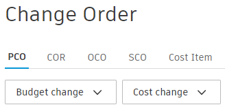

  4. Click Budget Change or Cost Change and choose the change order type.

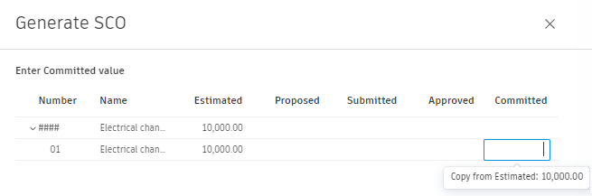

  5. Enter a committed value if necessary. You can copy cost item amounts from another column.
    Copy cost item amount button
    Tip: You can use a copy button on change order level as well.
  6. Click Generate. Tip: You can change the way you work with change orders. To learn more, see the Collaborative Potential Change Order Workflow article. Tip: You can also create change order transfers to move budgets between items without altering the total budget. For more details, see the Create Change Order Transfers section in the Potential Change Orders article.

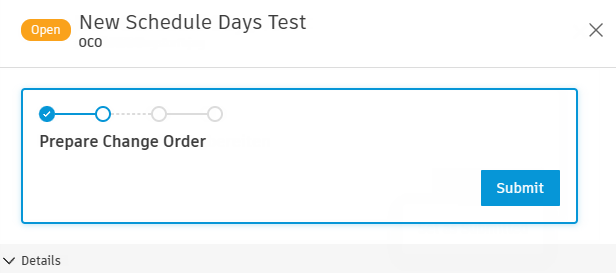

Your generated change order will appear in the appropriate tab. Switch to the relevant tab and find the newly created change order. Prepare a change request. To do that:
  1. Click on the relevant change order item. The details panel opens.
  2. Set the status as Open.
  3. Enter a scope of work if necessary. For example, fill in information in the Owner or Supplier Details section and add a Response Due date.
  4. In the Documents section, create a document package and add more attachments as required.

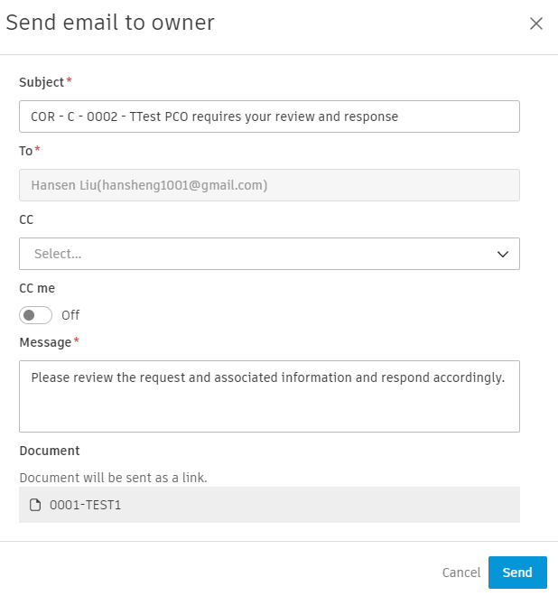

  5. Once your change order is ready to send, click Submit.
    Prepare change request example
  6. Check the information in the pop-up window. You can change this information by closing this window and returning to the details panel of the change order.
    Send email to owner example
    Tip: The owner's contact from the PCO flyout is the default recipient. You can change the owner's contact in the Company Setup setting.
  7. Click Send.

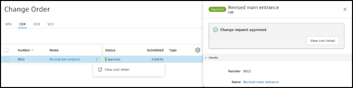

When a change order is in the:
A collaborator can read cost information or download documents in the view-only details panel. Click View Cost Detail in the More menu.
View cost detail example

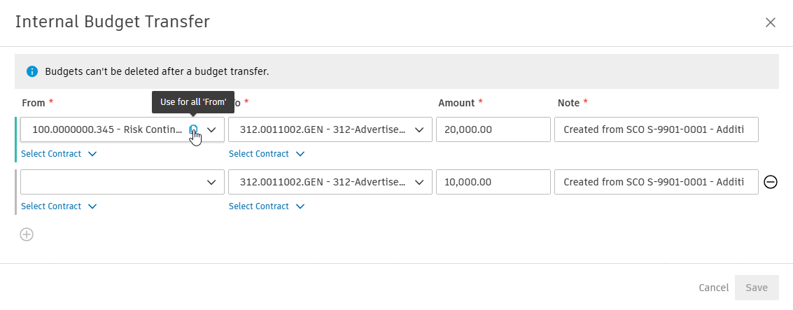

Create a Budget Transfer from SCO
Project administrators and members with both Budget and SCO full control permissions can create internal budget transfers directly from SCOs. This is useful when you need to move money from one budget item to another to pay for supplier change orders without requiring extra approvals.
To create a budget transfer from an SCO:

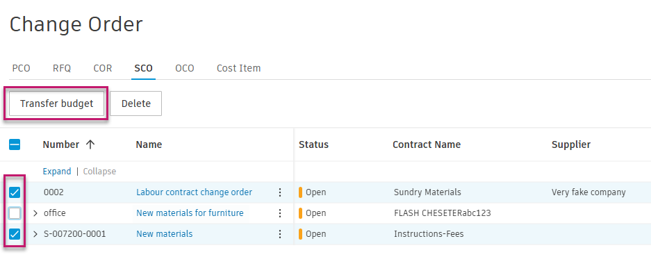

  1. Go to the Change Order tool and select the SCO tab.
  2. You can create a budget transfer in several ways:
    • From an SCO: Click the More menu Vertical more menu icon next to the SCO and select Transfer budget.
    • From a cost item: Open the SCO, find the cost item, click its More Vertical more menu icon menu and select Transfer budget.
    • From multiple items: Select multiple SCOs or cost items, then click Transfer budget in the batch actions.
      Batch transfer budget example
  3. Then, in Internal budget transfer:
    • Each selected cost item with a non-zero Committed value creates one transfer line.
    • For positive Committed values (money allocated), the system automatically uses the cost item's linked budget in the To field.
    • For negative Committed values (money being removed), the system automatically uses the cost item's linked budget in the From field.
    • The Amount is automatically set to the absolute value of the Committed amount.
    • A note is automatically added referencing the source cost item.
  4. Click Add Icon to add more transfers, even those that are not linked to the cost items. Those transfers are separated in the table.
  5. Click Delete Icon to delete a transfer from the list.
  6. You can use Copy to all "From" or Copy to all "To" buttons to quickly populate all transfer lines with the same budget.
    Copy to all "From" buttons example
  7. Click Save to create one or more internal budget transfers.
You'll receive confirmation that the budget transfer was completed.

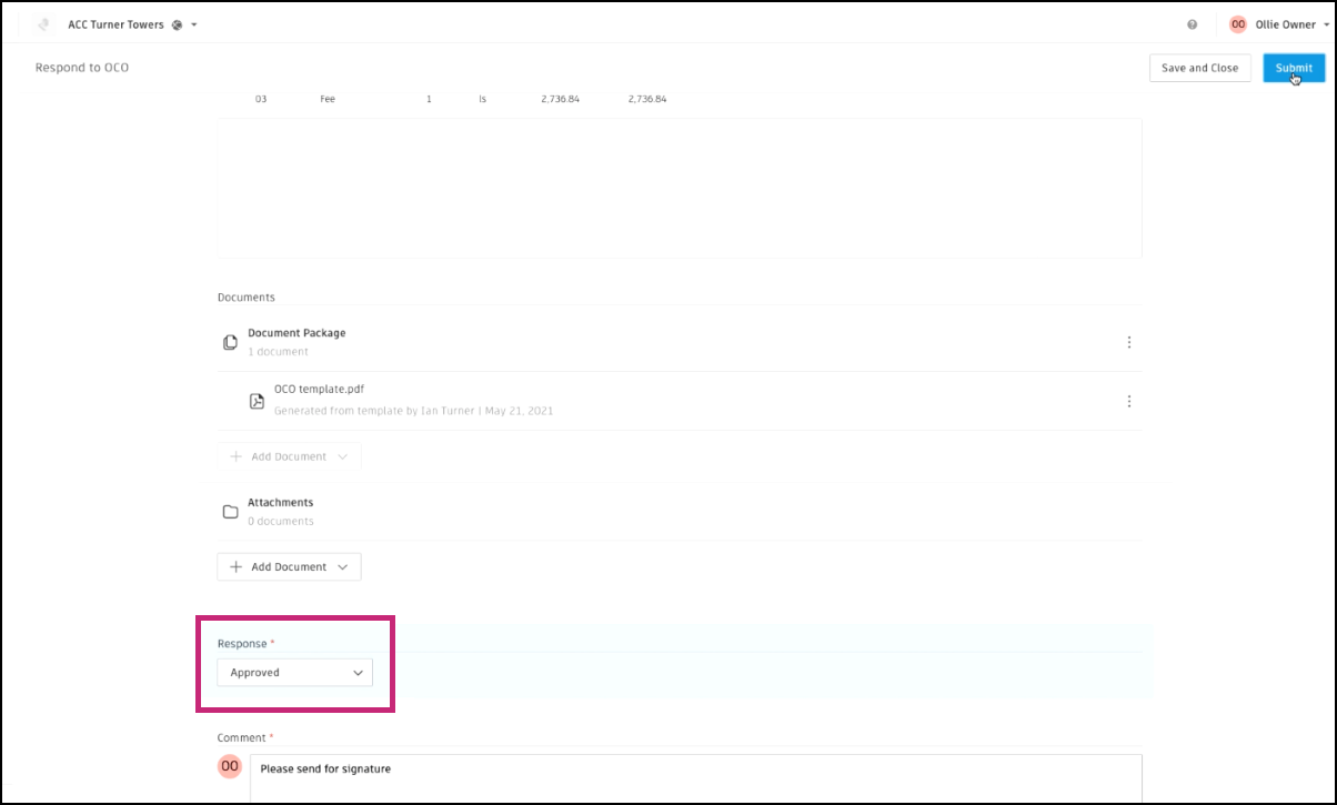

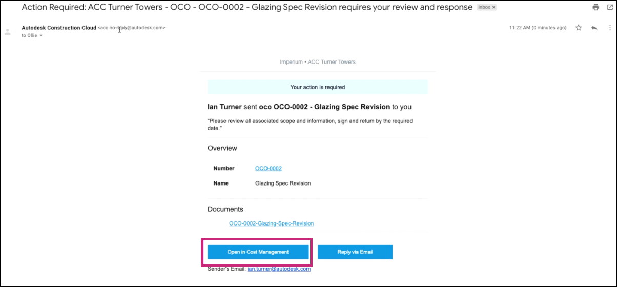

How Owners and Subcontractors Respond to Change Orders
Owners and subcontractors review and respond to change orders from email notifications, not from inside the workflow you use as a general contractor. They see only the information you've shared with them.
See Respond to Change Orders for both flows, including Receive and Respond to an OCO and Review and Respond to a Subcontractor Change Order.
