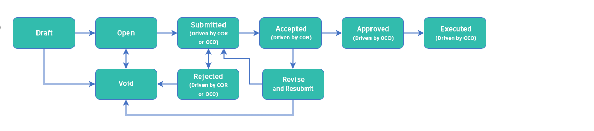

PCO Statuses
The following is a typical flow of statuses for PCOs:
Note: The
In Review budget status only appears when a project administrator has configured a PCO change request approval workflow (used when a PCO is used as COR). See
Approval Workflows.
Potential change orders have the following budget statuses:
- Draft: The initial status when the PCO is created.
- Open: When a PCO is set to Open, it formally enters into the system. All of its cost items are also set to Open. You can now generate an RFQ, COR, OCO or SCO, depending on the scope.
- In Review: An active approval workflow is triggered when the PCO is used as COR and a full control member submits the change request. See Approval Workflows.
- Submitted: Submitting the change order for approval activates this status. Cost items can no longer be added or removed.
- Accepted: The owner accepted the budget change through a COR.
- Revise and Resubmit: One from the party hasn't accepted the change order and requested revision. Check what is required and submit revised change order.
- Approved: The owner approved the budget change through an OCO.
- Executed: All parties have signed the budget change order.
- Rejected: Not accepted by the owner. You can revise and resubmit.
- Void: Only when a PCO and its cost items are not associated with any COR/OCO/RFQ/SCO, and no contract is generated from its cost items, the PCO can be void.

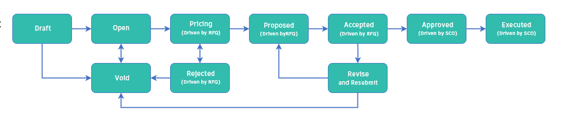

The following is a typical flow of statuses for cost PCOs:
Note: The
In Review cost status only appears when a project administrator has configured a PCO supplier quotation approval workflow (used when a PCO is used as RFQ). See
Approval Workflows.
Potential change orders have the following cost statuses:
- Pricing: Proposed price is agreed to for the cost change. Cost items can no longer be added or removed.
- In Review: An active approval workflow is triggered when the PCO is used as RFQ and pricing is submitted by a collaborator or set as proposed by a full control member. On approval, the PCO moves directly to Accepted, skipping Proposed. See Approval Workflows.
- Proposed: Cost items can no longer be attached to the PCO.
- Accepted: The cost change is accepted.
- Approved: The cost change is approved.
- Executed: All parties have signed the cost changes.
- Rejected: You can revise and resubmit.
To learn more about PCOs, see the Potential Change Orders article.

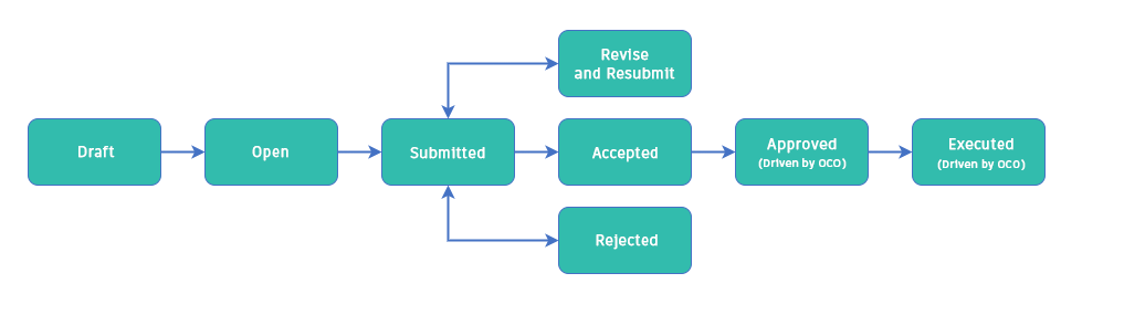

COR Statuses
Typical COR status workflow:
Requested change orders have the following statuses:
- Draft: During the creation state of a COR.
- Open: When a COR is set to Open, it formally enters into the system. COR documents can be generated.
- In review: An active approval workflow is triggered. See Approval Workflows.
- Submitted: Submitting the change order for approval activates this status. Cost items can't be added or removed. PCOs can't be attached.
- Accepted: The owner accepted the change order. You can generate an OCO or SCO.
- Approved: The owner approved the OCO containing this COR.
- Executed: All parties have signed the OCO containing this COR.
- Rejected: The owner didn't accept the COR. You can revise and resubmit the COR.
To learn more about CORs, see the CORs, OCOs and SCOs article.

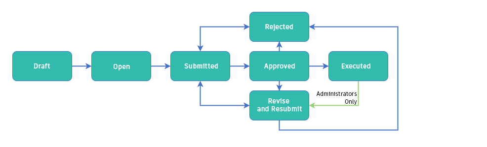

OCO Statuses
Typical OCO status workflow:
Owner change orders have the following statuses:
- Draft: During the creation state of an OCO.
- Open: When an OCO is set to Open, it formally enters into the system. You can now generate OCO documents.
- Submitted: Submitting the change order for approval activates this status. Cost items can't be added or removed. PCOs and CORs can't be attached.
- Revise and Resubmit: One from the party hasn't accepted the change order and requested revision. Check what is required and submit revised change order. Only project administrators can set this status when the change order is already executed.
- Approved: The owner accepted the change order. You can generate an SCO.
- Executed: All parties have agreed to the change order.
- Rejected: Not accepted by the owner. You can revise and resubmit the OCO.
To learn more about OCOs, see the CORs, OCOs and SCOs article.

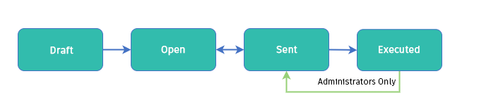

SCO Statuses
Typical SCO status workflow:
Subcontractor change orders have the following statuses:
- Draft: During the creations state of an SCO.
- Open: When an SCO is set to Open, it formally enters into the system. SCO documents can be generated.
- Sent: The cost change is approved and the SCO is sent to the subcontractor. Cost items can't be added or removed.
- Rejected: The reviewer didn't accept the SCO. You can revise and resubmit the SCO.
- Executed: All parties have signed the change order.
To learn more about SCOs, see the CORs, OCOs and SCOs article.

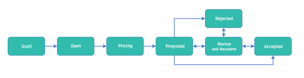

Statuses for RFQs
Typical RFQ status workflow:
Note: The
In Review status only appears when a project administrator has configured an RFQ approval workflow. See
Approval Workflows.
Request for quotations has the following statuses:
- Draft: During the creation state of the RFQ.
- Open: When an RFQ is set to Open, it formally enters into the system. RFQ documents can be generated.
- Pricing: RFQ was sent to the supplier for pricing. Can add cost items and generate documents.
- In Review: An active approval workflow is triggered after the supplier submits pricing or a full control member sets the RFQ as proposed. On approval, the RFQ moves directly to Accepted, skipping Proposed. See Approval Workflows.
- Proposed: The proposed price is agreed upon for the cost change. Cost items can no longer be attached to the RFQ.
- Accepted: The change order is accepted. You can generate a SCO.
- Closed: Extra status, set when a request is closed.
To learn more about RFQs, see the Requests for Quotation article.
