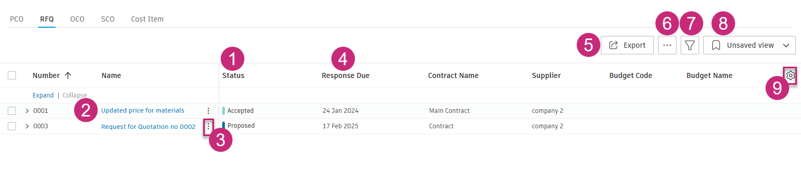

RFQ Tab Overview
The Request for Quotation (RFQ) tab is within the Change Order tool in Cost Management. Tab names can be customised by project administrators within settings.
RFQ tab overview
  1. The item's status automatically updates to Draft after an RFQ is generated from a PCO.
  2. Select the item's name to open the flyout panel. Editing the RFQ can be done within the flyout panel. In the flyout panel, selectable workflow-based actions will appear to guide you through the change order management process.
    RFQ workflow actions in the flyout panel
    For example:
    • When the RFQ status is Open, the Request Quotation button is visible. Note that a supplier needs to be listed in the Supplier Details section.

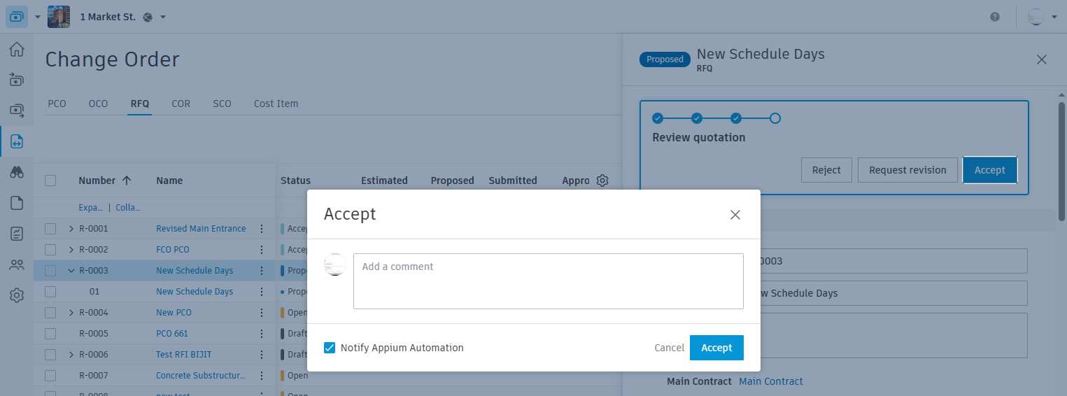

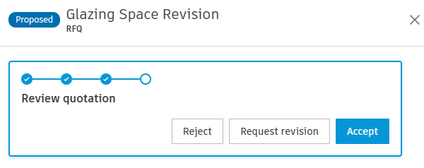

    • Once the RFQ is sent, the next options appear: Set as Proposed or Reject and so on.
    • When Accepted, select SCO to generate a Supplier Change Order.
  3. Click the More menu Vertical more menu icon to generate change orders, set the status of the RFQ or delete the item.
  4. The Response Due column will be populated when a date is added in the dates section of the flyout panel.
  5. Click Export to create an RFQ report.
  6. Click this icon to show or hide change orders' hierarchy. To learn more about using the hierarchy view to navigate between related change orders, see the Navigating Change Orders with Hierarchy View section.
  7. Click the Filter icon to filter and group the table.
  8. See the available predefined views of the table or save the current view of the table.
  9. Select the Settings gear icon icon to edit the position and visibility of columns within the table.
    Tip: By activating an Attachments column, you can instantly view the quantity of attachments for each RFQ, without the need to click each one individually.

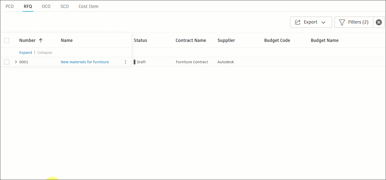

Generate an RFQ from a PCO
Important: Before you can generate an RFQ document, a project administrator must create the RFQ document template in the Project Admin module. See the Document Templates in Cost Management article to learn more.
As a project administrator, you can generate an RFQ after the RFQ document template is created and a cost item associated with a budget is assigned to a PCO. To do so:
  1. Select the Change Order tool.
  2. Select the PCO tab.
  3. Tick the box for a PCO.
  4. Click the More Vertical more menu icon menu.
  5. Choose Cost Change and then Generate RFQ. Individual RFQs are created for each cost item within the PCO.
  6. Switch to the RFQ tab and check the newly created RFQ.

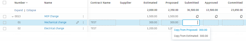

  7. Enter the necessary values into the Estimated and Proposed columns. You can copy cost item amounts from another column.
    Copy cost item amounts from another column in the RFQ table
  8. Open the newly created RFQ by clicking on its name. The flyout panel opens.
  9. Click Set as Open.

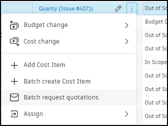

Batch Request Quotations

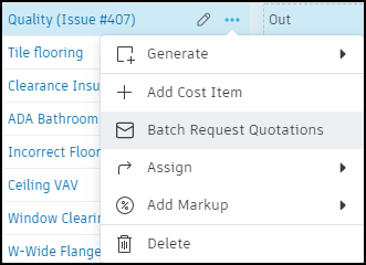

In addition to generating an individual RFQ, you can batch-request quotations from a PCO. A batch-request quotation is useful when a change occurs, and it is unclear who might be affected by this change. To reduce the risk of missing anyone, send a batch request to all suppliers to let them indicate whether they are affected or not and keep a record of their response.
To create a batch request:
  1. Click the Change Order tool.
  2. Click on the PCO tab.
  3. Click the More Vertical more menu icon menu of a PCO and choose Batch Request Quotations.
    Batch request quotations option in the PCO More menu

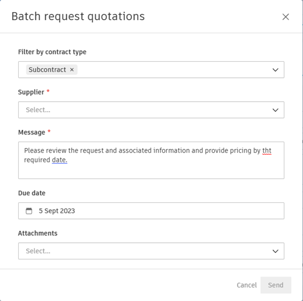

  4. You can add a filter for contract type in the newly opened window.
  5. Select one or more suppliers.
  6. Optional: In CC, select project members who should receive a copy of the batch request email.
    Batch request quotations window with contract type filter, supplier, CC, message, due date and attachment fields
  7. Write a message to be included with the request.
  8. Select a Due date.
  9. If necessary, choose Attachments to include.
  10. Click Send.

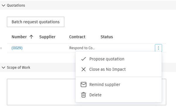

Placeholder cost items are generated for each supplier and are shown in parentheses. Suppliers can respond by saying no impact or can propose a quotation.
Placeholder cost items shown in parentheses in the PCO table
The placeholder cost items will be converted to regular cost items when a quotation is proposed.
