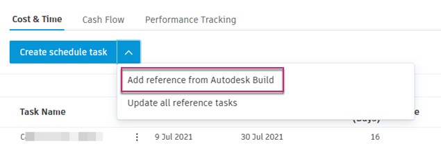

Create a Schedule Task by Adding a Reference from Autodesk Build
To do so:
  1. Go to the Forecast tool from the left navigation.
  2. In the first Cost & Time tab, select the arrow next to the Create Schedule Task button, then select Add reference from Autodesk Build.
    Add reference from the Autodesk Build option in the Create Schedule Task drop-down menu

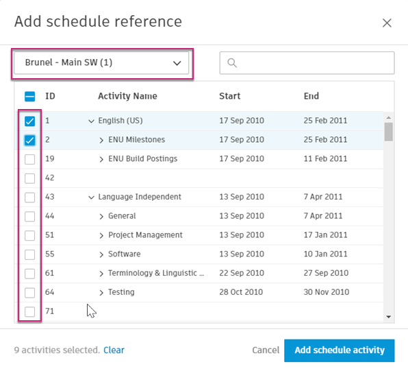

  3. The Add schedule reference dialog box will appear. Use the drop-down menu to choose the appropriate schedule.
  4. Select tasks that you want to pull over.
    Add schedule reference dialog box showing schedule drop-down and task selection
  5. Select Add schedule activity to automatically bring the tasks into the Cost & Time tab in Cost Management.

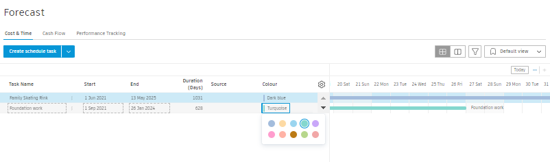

  3. Click Create Schedule Task.
  4. Enter a Task Name.
  5. Select a Start and End Date.
  6. Pick a colour for the Gantt chart.
Cost & Time tab showing schedule tasks in a Gantt chart view with task details

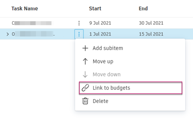

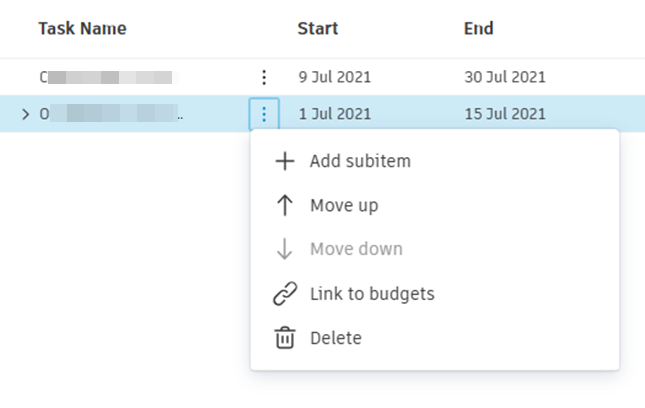

Once the task has been created, use the More menu More menu icon in the task table to do any of the following:
More menu options for schedule tasks including Add subitems, Move up, Move down, Link to budgets and Delete

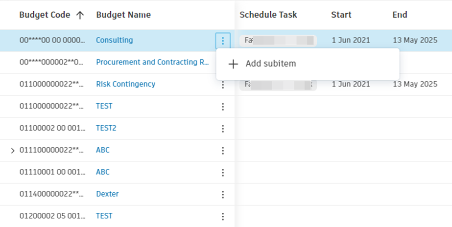

All budget items are automatically pulled into the budget section underneath the schedule tasks.
To link a schedule task to a budget item:
  1. Use the More menu More menu icon in the budget table.
  2. Click Link to budgets.
    Link to budgets option in the More menu

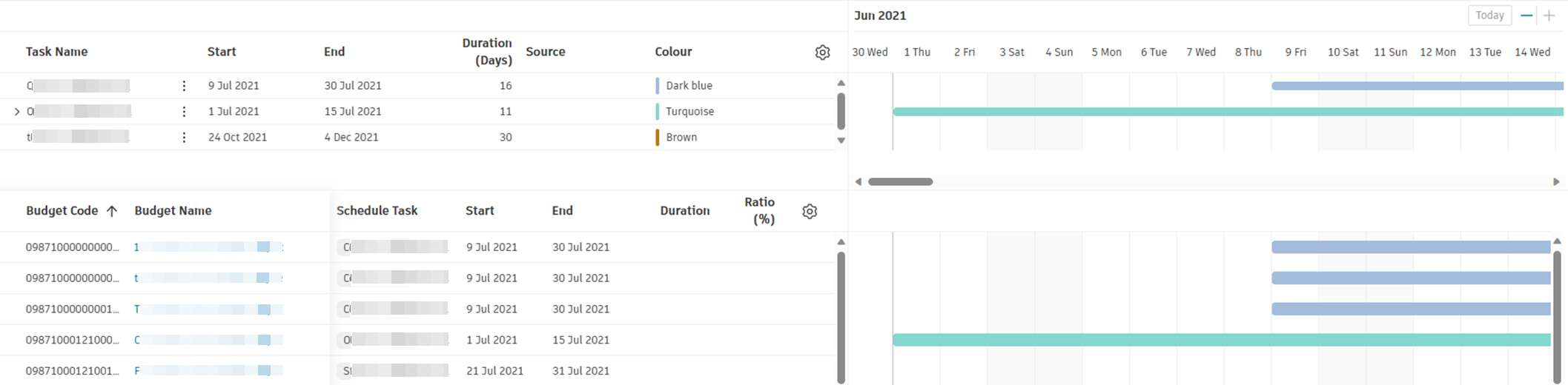

Once linked, the bar colour of the task and budget item will be the same. The start and end dates will be linked automatically as well. You can change the dates manually.
Gantt chart view showing linked schedule tasks and budget items with matching colours
