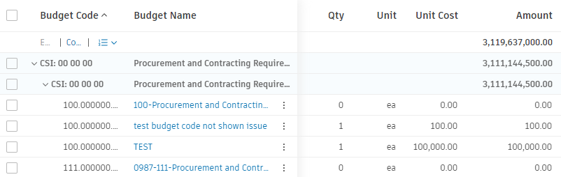

Tracking items are created from a budget. To start working with the Performance Tracking workflow, you need to have a budget added with the budget code segments defined. Add unit, quantity, unit cost and the amount of the budget you want to perform tracking on.
Budget example with unit, quantity, unit cost and amount fields
Tip: You can set your budget as time-related or item-related. If it is time related, make sure you set a time-related unit (for example, hr).

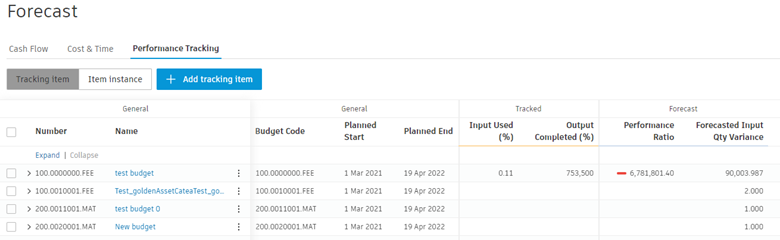

  1. Select the Forecast tool in Cost Management.
  2. Switch to the Performance Tracking tab.

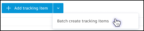

  3. Select Add tracking item or Batch create tracking items from the drop-down menu.
    Add tracking item and Batch create tracking items dropdown menu
  4. Search by Budget Code and choose the budget or budgets that you want to track.

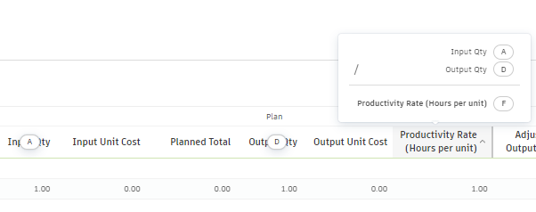

Tip: Understand the logic of the Performance Tracking table’s columns by hovering over their names.
Performance Tracking table column description tooltip

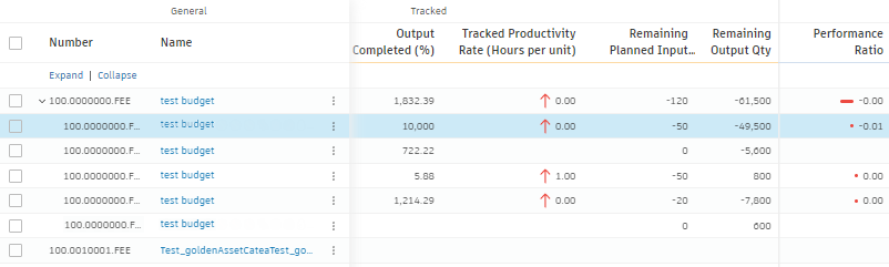

Monitor Performance Ratio
Every time you update a tracking item instance with current values, you can see the changes in the Performance Tracking table. The table allows you to monitor the relationship between planned and tracked performance in three views, which you can change according to the type of work:
Performance Tracking view options for different types of work
While the first two are more detailed, the Performance Summary view shows the simplified data:
Performance Summary view showing simplified tracking data

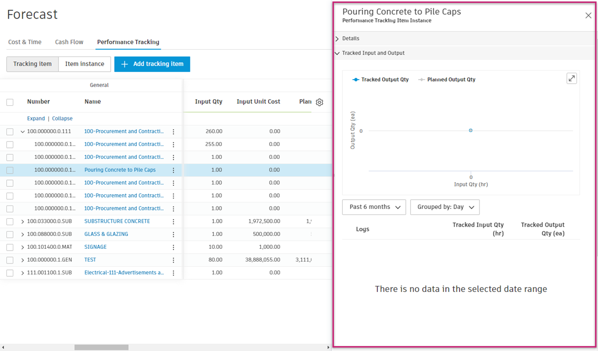

For more insights, open the flyout panel to view detailed logs and charts:
Performance tracking flyout panel with detailed logs and charts Tip: You can filter and group the items in the table and save those views for future use. You can also add or remove columns by using the Settings icon icon.

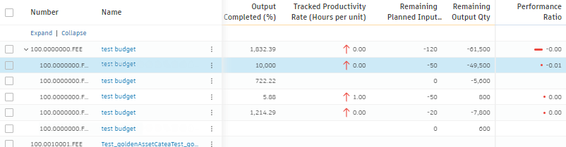

Performance Ratio
You can see if your team on the job site is:
For example, the planned productivity rate is three hours per installation of one window. If the tracked productivity rate is two hours per window, the ratio is greater than 1 – your team is overperforming.
Performance tracking showing overperforming team with green indicator
In the Performance Ratio column, you can also see the progress bar, which shows the performance of the tracking item. The colour of the progress bar is calculated by the proportion of performance on the instances. Even if the progress bar shows 1.00, one of the instances may be overperforming, while others may be underperforming. You can dive into details to view the actual performance in each instance.
Performance Tracking instances showing detailed performance breakdown
Tip: You can see the details panel by clicking on the instance item in the Performance Tracking table. In the Tracked Input and Output section, you can see the relationship between those values and decide to make forecast adjustments if necessary.

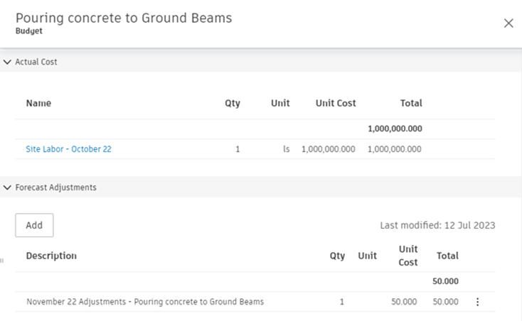

Add Forecast Adjustment from a Tracking Item
The forecast section within the table calculates the required performance to help keep you on track. It also shows any variances from the plan. The system will forecast an indicative end cost by using actual trending costs to date and calculated variance.
You can add a forecast adjustment from a tracking item when you see any issues in the performance and want to adjust the budget accordingly.
To add a forecast adjustment:
  3. Select the More menu More menu icon next to the tracking item.
  4. Choose Forecast Adjustments. The Edit Forecast Adjustments window shows. You can select one of the two options:
    • Add – to manually add an adjustment.
    • Add from Tracking Item - to choose from the existing tracking item. The adjustment is calculated by multiplying the additional hours needed to complete the task (based on tracked performance or Forecast Input Qty Variance) by the latest approved price per hour (Trend Unit Cost). This reveals the extra costs required.
    Tip: You can add as many forecast adjustments as you want.
  5. Once ready, exit the window. Adjustments are added at once.
You can view your forecast adjustments in various budget-related sections. For instance, they are visible in the Forecast Adjustments section within the details panel of the budget.
Forecast adjustments section in budget details panel
