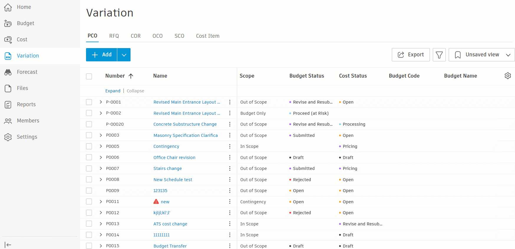

Customise Tab and Tool Names
Project administrators can customise Cost Management so that the tool and tab names match the terms used by your company. You can also change the order of the tools and tabs.
Warning: If you customise the tabs or column names, the instructions in the help may be hard to follow. As a best practice, create a spreadsheet of the changes for other Cost Management members that are not project administrators.
To customise tabs and tools in Cost Management:
  1. Select the Settings tool from the left navigation.
  2. Select the General tab.
  3. Go to the Tab Names and Order section.
  4. Enter replacement names in the Customised column.
  5. Select the More menu More menu icon to reorder the tabs.

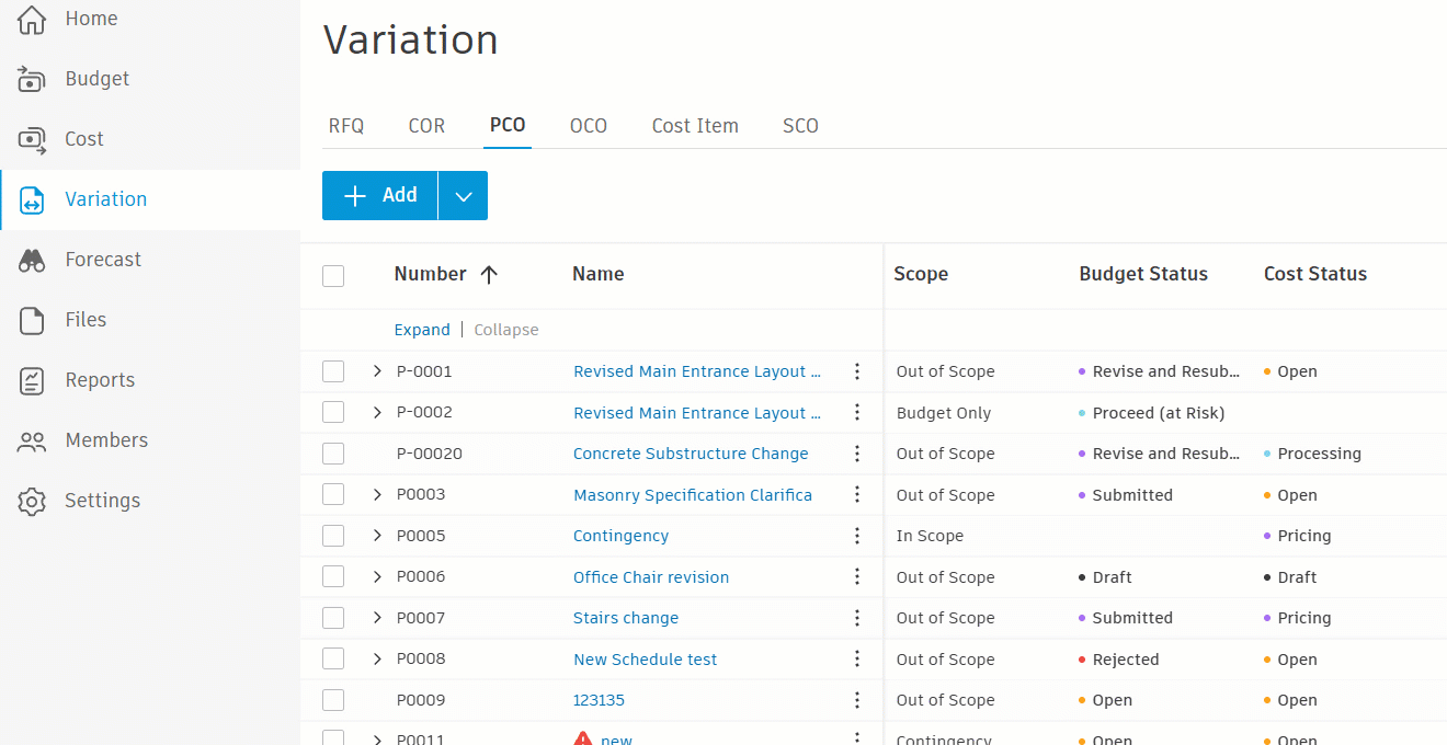

See the following animation to learn how the change order tabs can be reordered:
Animation showing how to reorder change order tabs in Forma Build
See the following animation to learn how the change order tabs and tools can be renamed:
Animation showing how to rename change order tabs and tools in Forma Build
Note: The tab names seen in the videos (for example, Income) are customisable within the Settings tool.

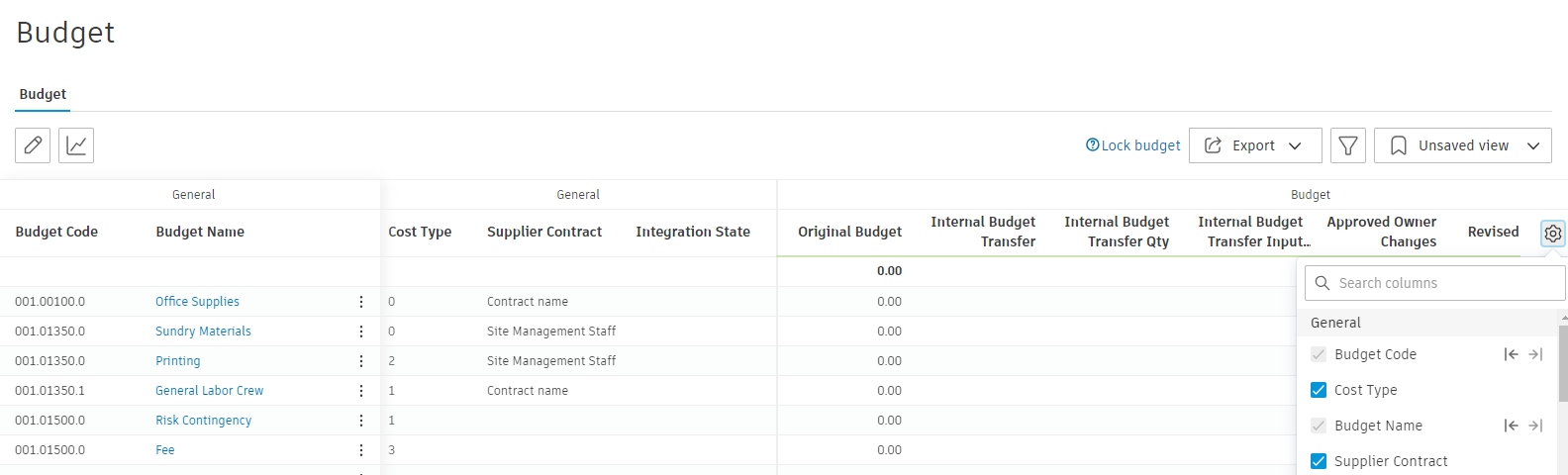

Control Column Order and Visibility
The tables in Cost Management can be difficult to deal with while extracting specific information. You can control the tables by snapping columns to the left or right, showing or hiding columns, changing the order of columns or resetting the default view.
You can access the table settings with the Gear icon icon:
Budget table settings panel
This short animation shows the example of customising the Budget table:
Animation showing how to customise the Budget table columns and layout
Note: The tab names seen in the video (for example, Income) are customisable within the Settings tool.

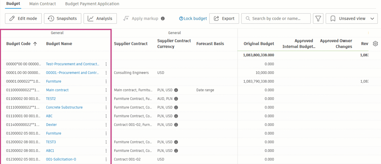

Snap Columns
To snap columns:
  1. Hover over a column.
  2. Use the icons to snap to the left or right Snap column icon.
  3. Click again or select Reset to restore the default view.
Note: The snapped columns remain in their original order.

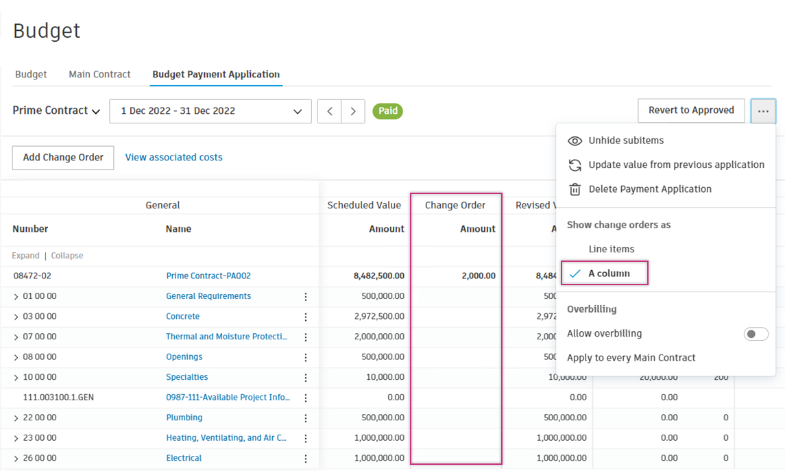

Column mode
The Column mode presents change orders in a column.
This option is available in the Budget Payment Application, Main Contract, as well as in detailed view of Contract SOV, Cost Payment Application and Contract.
Column mode view showing change orders as columns
To show change orders as columns, click the three-dot menu and select the view.
Column mode option in the three-dot menu
Learn more about Change orders.
