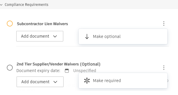

Make Requirements Optional or Required Navigate to any item's details panel and find the Compliance Requirements section:
Click the More menu next to any requirement.
Choose Make Optional or Make Required .
Note: If all requirements are optional, the item is considered compliant.

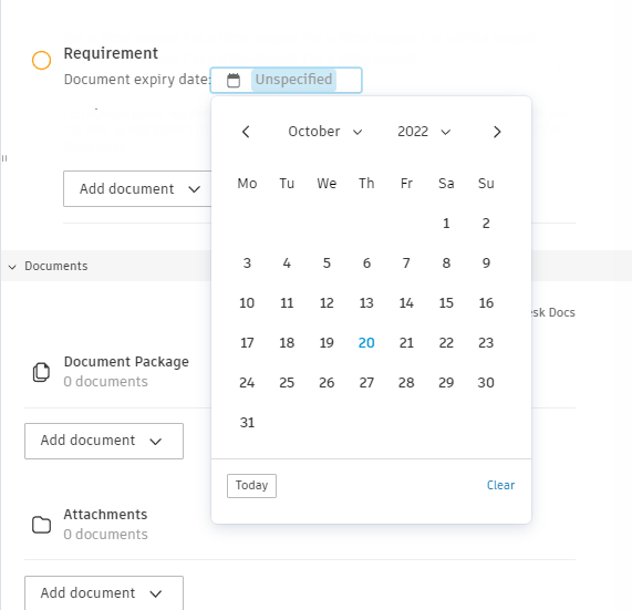

Set Expiry Dates For time-sensitive documents like insurance certificates:
In the requirement details, enable Requires document expiry date .
Members will be prompted to set expiry dates when uploading.
Expired documents will appear in calendar views and notifications.

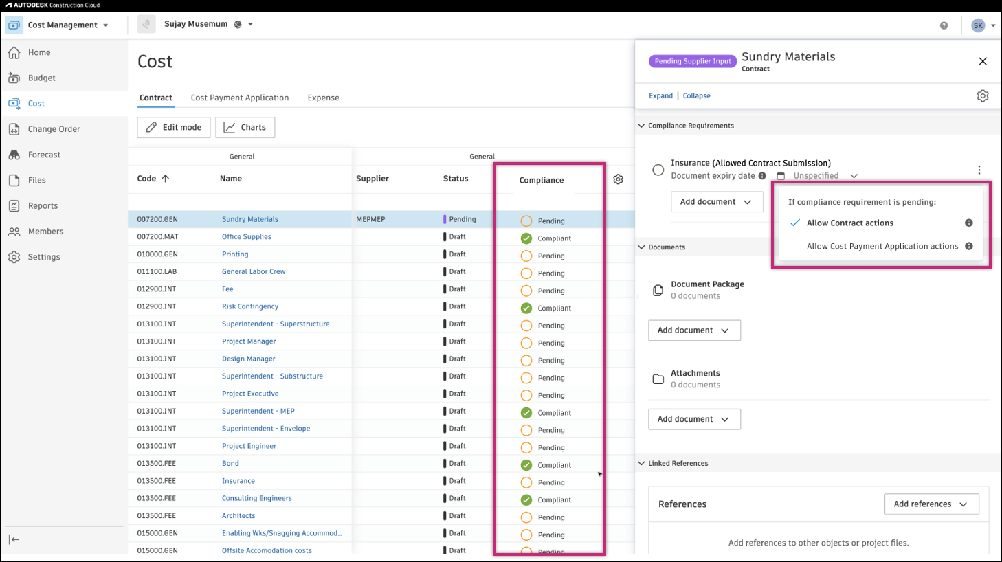

Step 4: Track and Monitor Compliance Monitor Compliance Status The compliance column in overview tables shows real-time status:
Compliant : All requirements met
Pending : Documents needed
Not Applicable : No compliance requirements apply to this item
Not Required : Compliance requirements are not mandatory for this item
Note: You can unblock and allow submission actions even when compliance is pending.

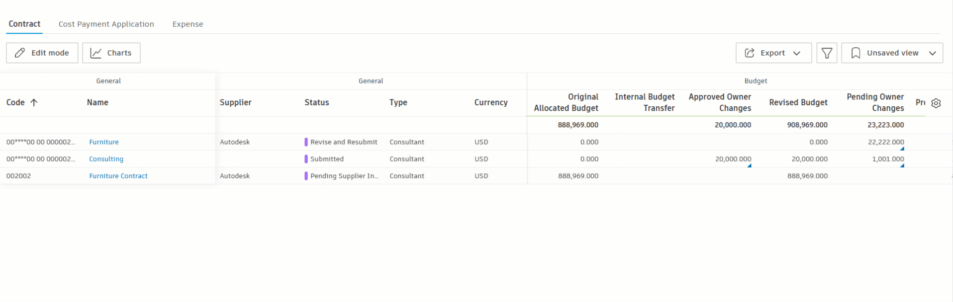

View Compliance Status in Tables Add the Compliance Document Exp. Date column to track expiry dates:
Go to the relevant tab (Contract , Cost Payment Applications , RFQs or SCOs ) in the Cost or Change Order tool.
Click the icon.
Find and select the Compliance Document Exp. Date column.
The column appears in the Dates section. Use grouping by dates to quickly identify upcoming expiries.
