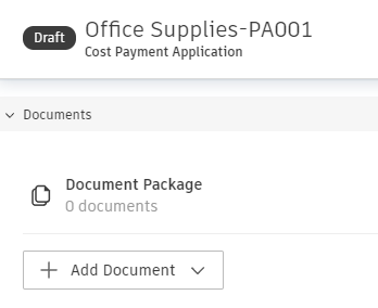

Select the item name in the General section of the table. A details panel opens.

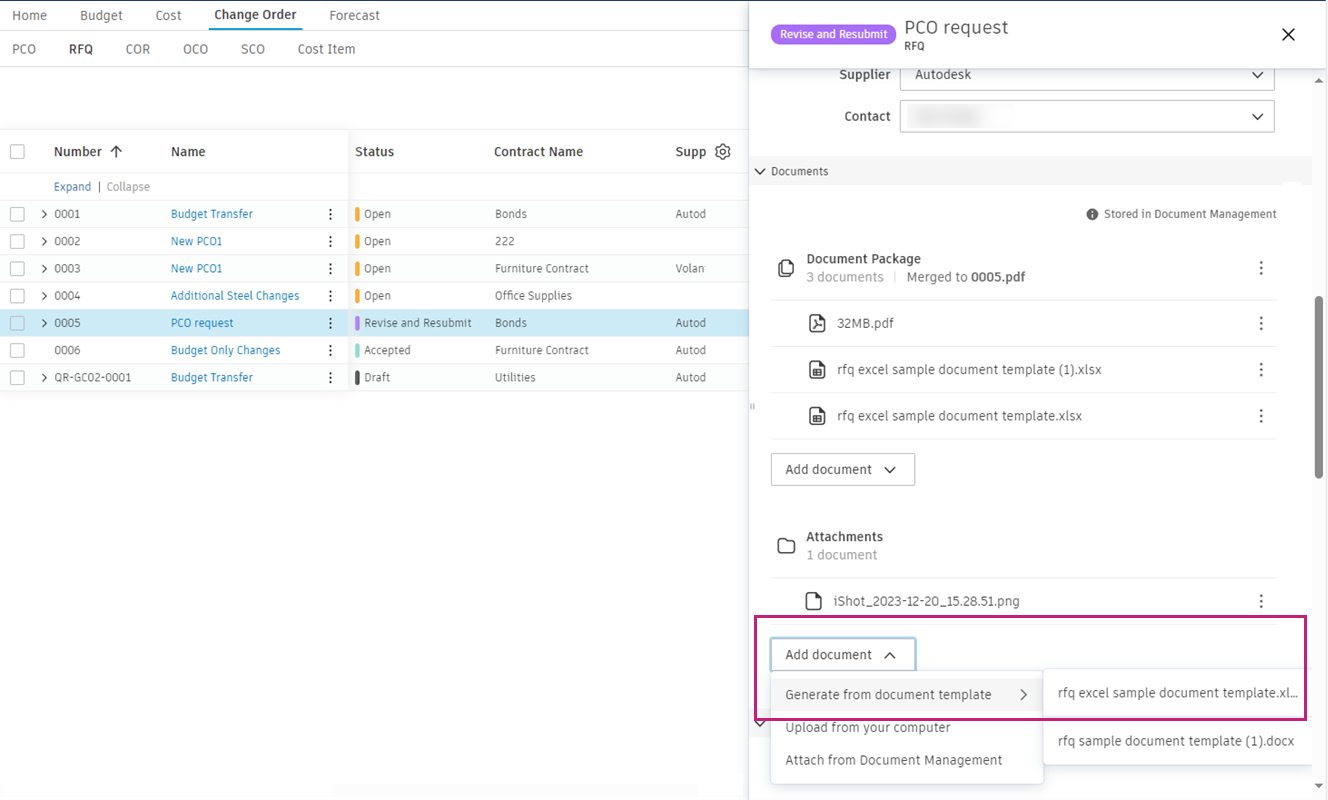

Click Add Document in the Documents section.
Import files to be attached with a contract, change order or payment. You can choose from:
From existing work:
- Recently Generated: The newest documents generated, if any.
- Add From Cost Payment Application: For budget payment applications. Transfer documents from the linked cost payment application.
- Add From Expense: For budget payment applications. Add documents from the linked expenses.
From other project processes:
- Add From PCO: For any change order. Add documents from a potential change order, which is the starting point of the change order workflow.
- Add From RFQ: For change order requests (COR) and supplier change orders (SCO). Use when you want to include request for quotation documentation.
- Add From COR: For owner change orders (OCO). Use when creating owner-initiated change orders.
- Add From Cost Item: For any change order. Use when you want to create change orders from cost items.
- Add From Linked References: For any change order. Include detailed reports from linked references such as RFIs, issues, submittals, assets, forms, and files.
Create new documents:
From external sources:
- Upload From Your Computer: Attach documents from your computer.
- Attach From Autodesk Docs: Select a document from the Files tool. You can make this option available in the Documents and Attachments in Cost Management section in the Settings tool.

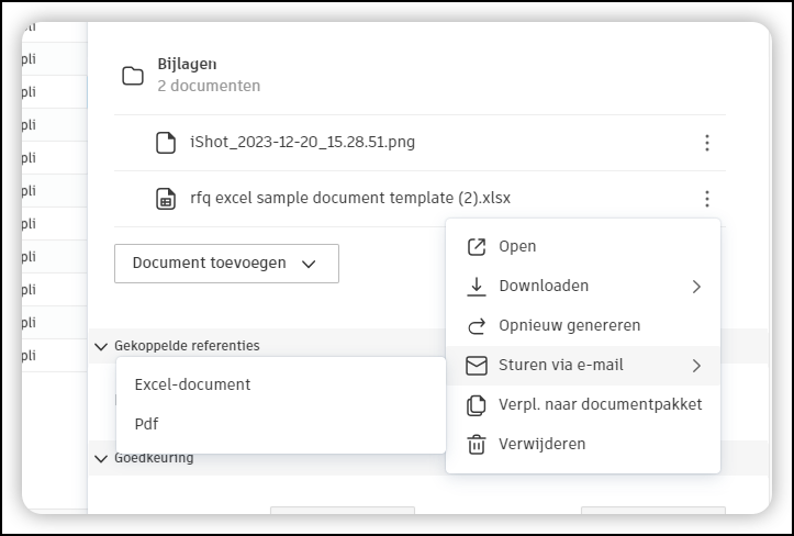

Individual Document Actions

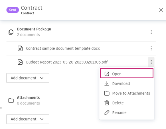

Single document actions (apply to specific documents):
Open a document in BIM Viewer for advanced viewing and editing capabilities, such as adding markups to PDFs.
Download a Word or PDF document to your computer for offline viewing or editing.
Regenerate documents to update them with the latest data, or detach a generated document from a document package and move it to attachments.
Move to Attachments to reorganise your documents. This procedure is reversible, so you can move documents back to the package if needed.
Delete a document from a package permanently.
Rename a document to better reflect its content or purpose.

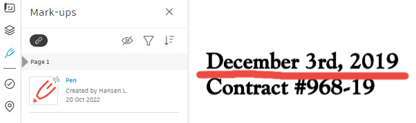

Add Markups to a Document
You can add markups to a PDF document. It may be helpful, for example, during the approval workflow review process.

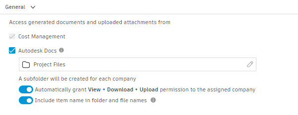

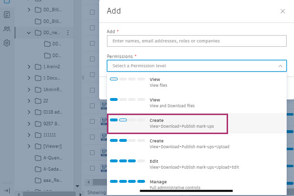

To enable adding markups to a PDF document, the project administrator has to:
Select the Autodesk Docs option in the General settings.
Grant reviewers the Create permission for the folder that stores the generated PDF document.
Then, when reviewers open a PDF document from the Cost Management document section, the BIM Viewer will automatically enable the Markup panel.
To add markups to a Cost Management document, follow these steps:
Navigate to the Documents section in the flyout panel of the contract, payment application or any change order that you want to mark up.
Find the PDF document that you want to mark up, and click the More menu
icon next to the PDF document.
Select Open. The PDF document will open in the BIM Viewer.
Once the document is open, you can start adding markups to it. Refer to the Markups article to learn more about the different markup tools and actions that are available.
