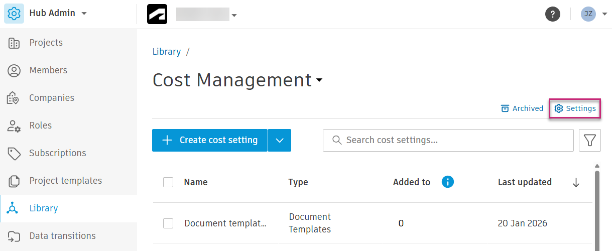

To configure the TradeTapp integration:
  1. Go to Hub Admin, then click Library and choose Cost Management.
  2. Click Settings.
    Cost Management in Library showing Settings button

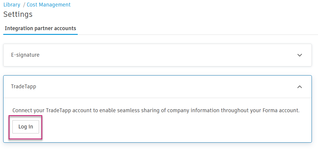

  3. Find TradeTapp in the list of integration partners.
  4. Click Log in.
    TradeTapp login button in integration partner accounts
  5. Sign in to your TradeTapp account when prompted.

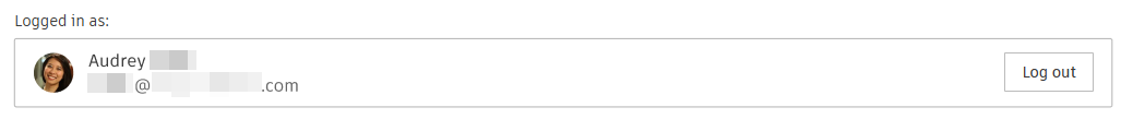

Once you sign in, the system displays your logged-in status with your account information.
TradeTapp logged-in state showing user account
Note: A licensed user needs to sign in to the new setting in the Library/Cost Management Settings. This is similar to how e-signature account authentication works.

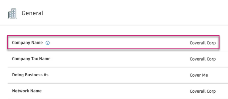

TradeTapp provides four company name field options to handle different naming scenarios. This flexibility solves the common challenge of using legal entity names versus ‘doing business as’ names in contracts.
Understanding the company name fields:
In TradeTapp, there are four choices you can select from to set the one to be used as “Company Name”. This is the field that Cost Management uses. The system lets you choose between:
The Company Name field is the one Cost Management uses to populate supplier information in contracts. You can use this to solve situations where you need to use a ‘legal entity’ versus ‘doing business as’ name and address in contracts.
Company name in TradeTapp
Important:
  • The Tax ID is used to match supplier companies between TradeTapp and Cost Management. Make sure supplier Tax IDs match in both systems for automatic data synchronisation.
  • The Company Tax Name is set from your TradeTapp account settings and can't be modified within the integration settings.

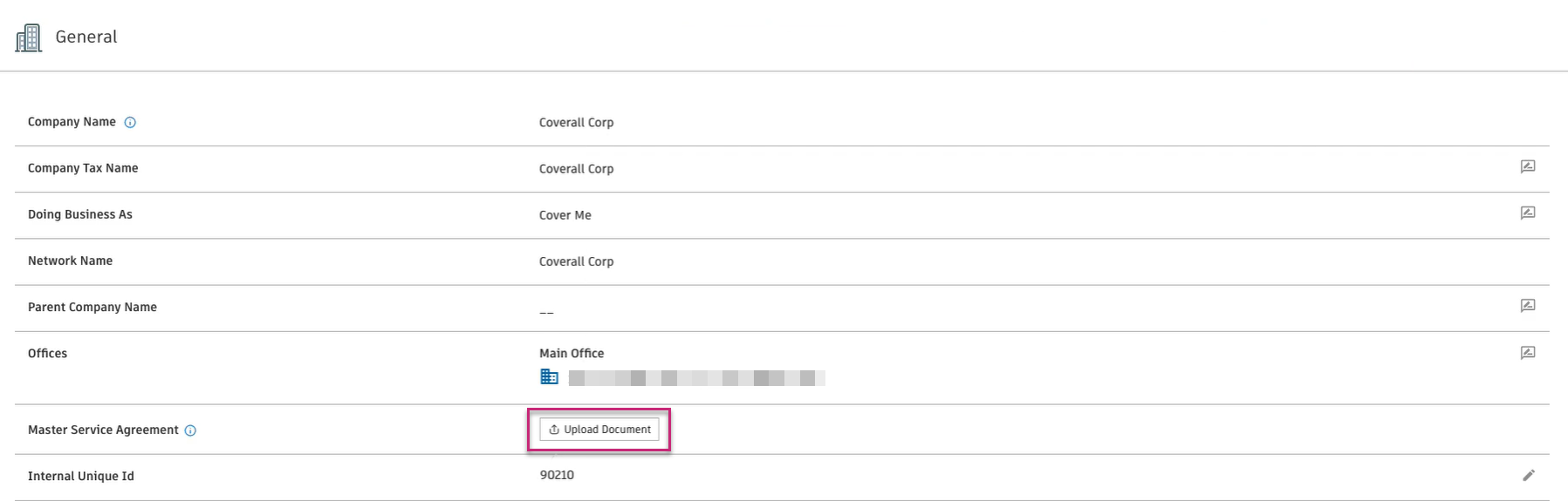

You can upload Master Service Agreements (MSA) in TradeTapp to track contract terms and validity periods. These agreements automatically appear in the contract flyout in Cost Management once uploaded.
To upload a Master Service Agreement:
  1. In TradeTapp, navigate to the company's General tab.
  2. Scroll to the Master Service Agreement section.
  3. Click Upload Document.
    Master Service Agreement upload dialog
  4. In the Upload MSA Document dialog, enter the Effective date. This field is required.
  5. Optionally, enter the Expiry date to track when the agreement expires.
  6. Click Upload Document to select your MSA file from your computer.
    Note: Only PDF files with a maximum size of 5 MB are supported.
  7. Click Upload to save the document.
The uploaded MSA document now appears in the Master Service Agreement section with the effective date displayed. In Cost Management, you can access this document directly from the contract flyout, in the Qualification and Risk Profile section.

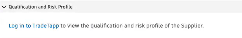

View Qualification and Risk Profile in Contracts
Once the TradeTapp integration is configured, the Qualification and Risk Profile section appears in contract flyouts. This section displays comprehensive supplier information synced from TradeTapp.
To view qualification and risk profile data:
  1. In Cost Management, select the Cost tool from the left navigation.
  2. Open a contract to display its flyout.
  3. Scroll to the Qualification and Risk Profile section.
  4. Click Log in to TradeTapp to view the full qualification and risk profile of the supplier in the TradeTapp platform.
    Contract flyout showing qualification and risk profile section

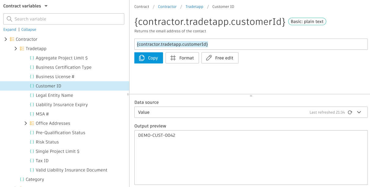

Use Document Variables for TradeTapp Data
Document variables let you automatically pull TradeTapp qualification data into your contract templates. This feature ensures consistency and reduces manual data entry when generating contract documents.
To learn how to access and use the Variable Finder tool, see Variables in Cost Management. The Variable Finder lets you browse available variables, preview data and copy variable syntax for your templates.
Available TradeTapp Variables
In the Variable Finder, navigate to Contract > Supplier > Qualification to find related variables:
Variable Finder showing TradeTapp qualification variables
Master Service Agreement variables:
More qualification variables:
The Variable Finder provides access to more TradeTapp qualification variables, including:
Tip: Use the Variable Finder's Copy button to copy the exact variable syntax for any qualification field. Then paste it into your Microsoft Word or Excel document template. The Data source preview shows the latest five updated instances to help you verify that the variable will pull correct information.
