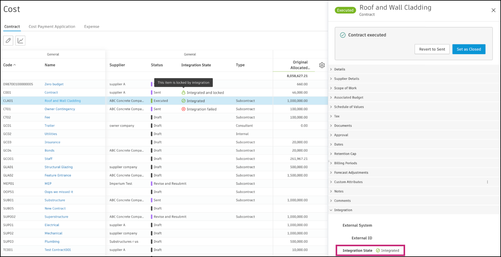

Since the ERP system is integrated with Cost Management, the Integrated and Locked status icon status will be visible in the:
Cost Management table view showing the Integrated and Locked status in the Integration State column

    Add, Manage and Filter by Integration State Column
    By adding the Integration State column to the Budget, Cost and Change Order tool’s table views, you can see which of the items, sections and actions are locked and integrated.
    To add this column to your views:
    1. Select the Budget, Cost, or Change Order tool from the left navigation.
    2. Switch to the tab where you want to add the Integration State column.
    3. Click the Settings gear icon icon.
    4. Check the Integration State option.
      Integration State option checked in the column settings panel
    After selecting, the column appears in the table view. Change its position by:

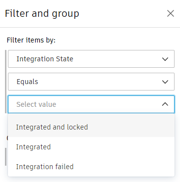

    You can also filter the table view by the status of the integration:
    Filter by integration status options in the table filter panel
