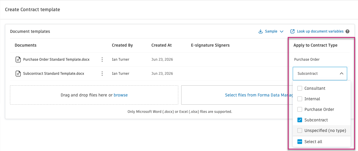

Restrict Contract Templates by Contract Type
By default, each contract document template is available for all contract types. Use the Apply to Contract Type setting to limit a template to specific contract types – for example, to prevent a Subcontract template from appearing on a Consultant contract.
When a member generates a document, only templates that include the contract's current type appear in the list.
To assign contract types to a template:
  1. Select the Settings tool from the left navigation.
  2. Switch to the Cost tab.
  3. Scroll down to the Document templates section and click Edit.
  4. In the Apply to Contract Type column, click the cell for the template you want to restrict.
  5. Select one or more contract types. To make the template available for all types, select Select all.
    Apply to Contract Type drop-down in the document templates table showing contract type options
  6. Click outside the drop-down to apply.
Note: If no contract type is selected, the template is unavailable for document generation on any contract.

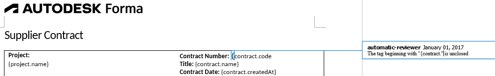

Review Invalid Variables
When variables in a template become invalid (due to system updates or errors), you'll see a Warning icon icon next to the affected template. To resolve:
  1. Click the More More menu icon menu next to the invalid document template.
  2. Choose Review Issues.
    Review issues option in menu
  3. The template is downloaded automatically. Open it to see comments next to invalid variables.
    Word document showing variable review comments
  4. Resolve the issues within the document.
  5. Upload the corrected template.
