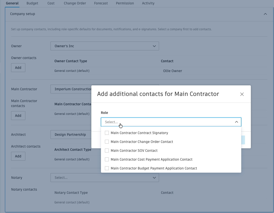

Company Setup
Company Setup defines default companies and contacts for key project roles. These contacts are used in document templates, as default recipients when sending change orders or payment applications, and in e-signature workflows.
For Owner, Main Contractor and Architect, you can assign a General Contact plus additional contact types for specific workflows – for example, a contract signatory who signs main contracts but not every change order, or a separate reviewer for budget payment applications.
Note: If you rename Owner or Main Contractor in Additional Terms, the contact type labels in Company Setup update to match.
To configure company roles:
  1. Go to the Settings tool and switch to the General tab.
  2. Expand the Company Setup section.
  3. For each role, select the company, then assign contacts to the contact types that apply to your project:

    Notary – Used for document templates that require notary information. Assign one company and contact.
Company Setup showing multiple contact types for Owner, Main Contractor and Architect roles

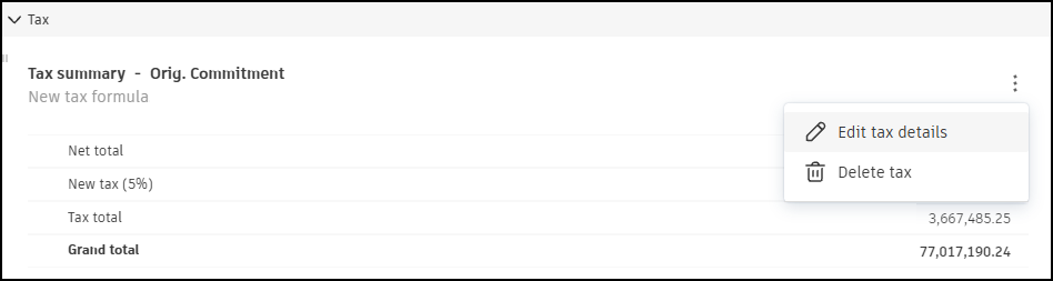

Tax Formulas
Use the custom tax calculation feature to calculate taxes in all cost processes and show tax in the generated cost documentation to comply with government requirements. Project administrators can add multiple tax formulas to control how taxes are applied for each contract, payment application and change order. Any existing formulas will be available in the list.
Create a Tax Formula
To create a tax formula:
  1. Within Cost Management, click Settings from the left navigation.
  2. On the General tab, click Tax Formulas and then Add.
    Cost settings tax formulas

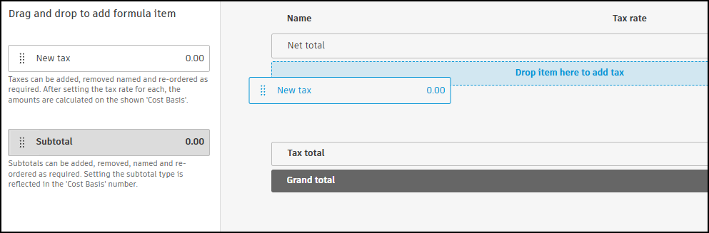

  3. Select the pencil icon to edit the formula's name.
  4. To update the net total default (1,000.00) in the centre preview panel, click Net Total.
  5. Drag a new tax into the centre column to add to the formula.
    Add new tax
  6. Click newly added New Tax to specify the Tax Rate as a percentage. The tax rate can be positive or negative. Negative tax rates are useful for figuring out CIS deductions.
    Edit new tax
    Important: If taxes in different tax formulas have the same name, they'll be combined into a single tax in the tax summary, regardless of the tax rate.
  7. Continue adding more taxes as needed to build out your formula. As you add taxes, the tax total is calculated based on the tax rate and the net total. Combined, these values produce the grand total. Taxes can be added, removed, named and reordered as required. After setting the tax rate for each, the amounts are calculated on the Cost Basis column.

    • Info Only to have the subtotal visible for informational purposes without recalculating the cost basis for subsequent taxes.
    New subtotal
    Note: If there are multiple taxes above the subtotal, the subtotal will display both the tax subtotal and the subtotal.
  10. Click Save to save the tax formula.

    If you levy a tax on a sent or executed SCO, it will be displayed under the contract tax. You'll be able to see the net total and tax total for all change order taxes that are related to the contract. You can expand to see more detailed information, including specific change orders that affect contract tax.
  5. If necessary, use the More menu Vertical more menu icon and choose Edit Tax Detail or Delete Tax.
    Cost tax more menu
    Editing the tax details allows you to turn on or off specific taxes as needed. The change is automatically updated in the Tax summary table.
