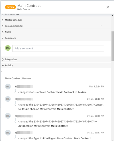

The flyout panel for each item in Cost Management displays its corresponding activities as well. For example, here is the list of the activities of the main contract:
The View of Activities for the Main Contract
