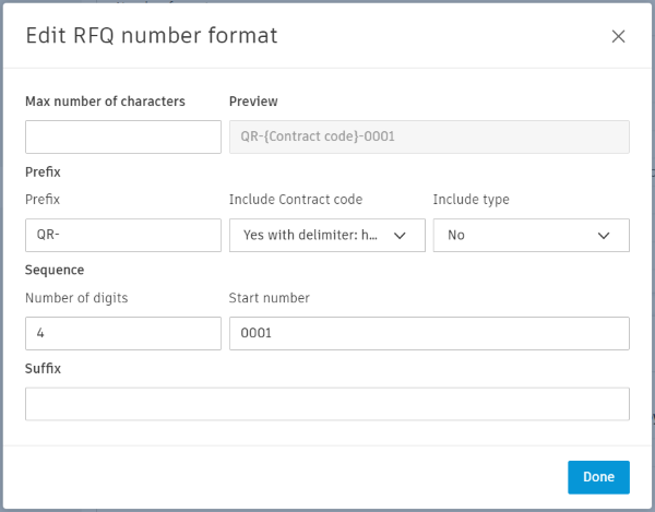

Number Format
Change the number format that is generated when you create change orders and cost items.
  1. Click on the Settings tool from the left navigation.
  2. Select the Change Order tab.
  3. Expand the Number Format section.
  4. Select the More menu More menu icon for the number format that you would like to define.
You can define:
Edit RFQ number format dialog

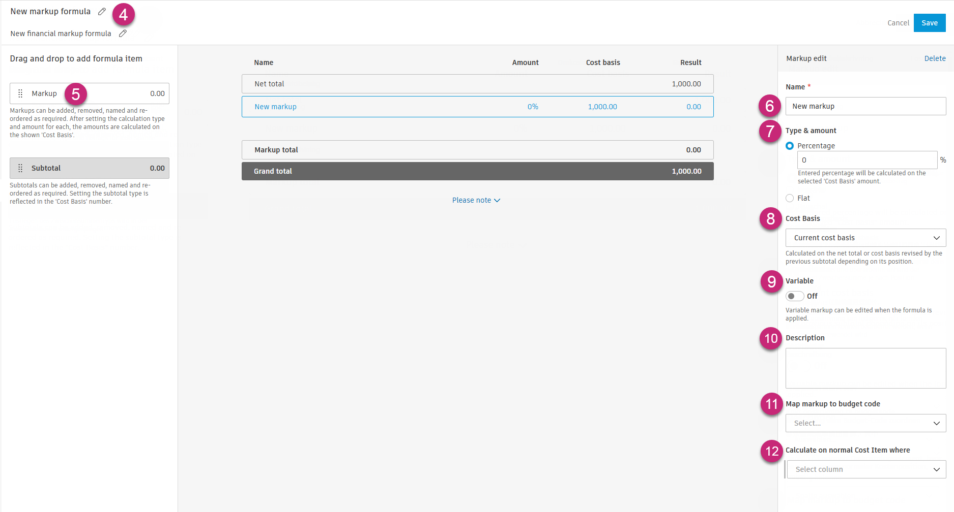

Create a Financial Markup for a Change Order
As a project administrator, you need to create a financial markup formula:
  2. Switch to the Change Order tab.
  3. Click Add in the Financial Mark-ups Formulas section.
  4. Name the new financial markup formula. You can also add an optional description by clicking the pencil icon.
  5. Click Markup from the left panel to add it to the formula.
  6. In the editor on the right, enter the name of the new markup.
  7. Select the markup type and amount. Available options include:
    • Percentage: Calculates the mark-up as a percentage of the cost basis.
    • Flat: A fixed amount applied as a total for the mark-up at the PCO level.
  8. Select the cost basis for the markup. Only available on percentage-based markups.
    • Current Cost Basis: Multiplies the percentage and the cost.
    • Net Total – Multiplies the net total amount.
    • Revised Cost Basis: Multiplies the following subtotal and percentage.
    • Preceding Mark-up Subtotal: Equals the total of all preceding mark-ups above the selected mark-up, excluding the net total.
    • Grand Total: Multiplies the calculated grand total and the percentage.
    • Preceding Total: Calculated on the total of net total and all preceding mark-ups.
  9. Toggle whether the variable can be edited when the formula is applied.
  10. Provide an optional description of the markup.
  11. By default, markups are calculated on all budget items. Click the Map Markup to Budget Code drop-down list to make a markup only apply to a specific budget code.
  12. Click Calculate on normal Cost Item where to select a column, operator, and value combination to apply the markup to. By default, markups are calculated on all budget items.
Financial markup formula configuration steps

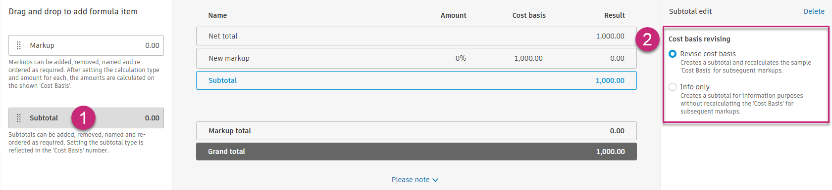

To add a subtotal to your financial markup formula:
  1. Click Subtotal from the left panel.
  2. Select the appropriate cost basis revision. Available options include Revise Cost Basis or Info Only:
    • Revise Cost Basis creates a subtotal and recalculates the sample cost basis for subsequent mark-ups.
    • Info Only creates a subtotal for informational purposes but does not recalculate the cost basis for subsequent markups.
Subtotal setting options
You can add more markups or subtotals as required. After everything is ready, click Save.

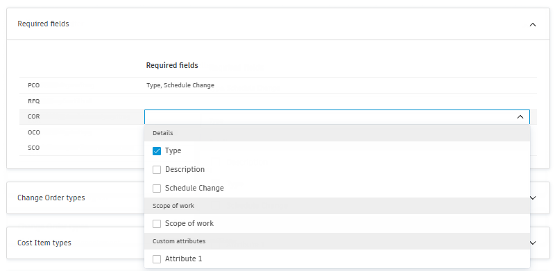

Required Fields for Change Orders
Project administrators can define a set of fields as required. This setting may be helpful when working with the change order workflow to prevent missing important information. To do so:
  1. Open the Settings tool from the left navigation.
  3. Scroll down to Required Fields.
  4. Select the drop-down list next to the change order.
  5. Choose the required fields for change orders. Custom attributes are also shown on the list.
Required fields for change order configuration
Required fields apply to all existing instances and to the ones that will be created in the future.

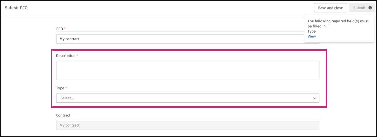

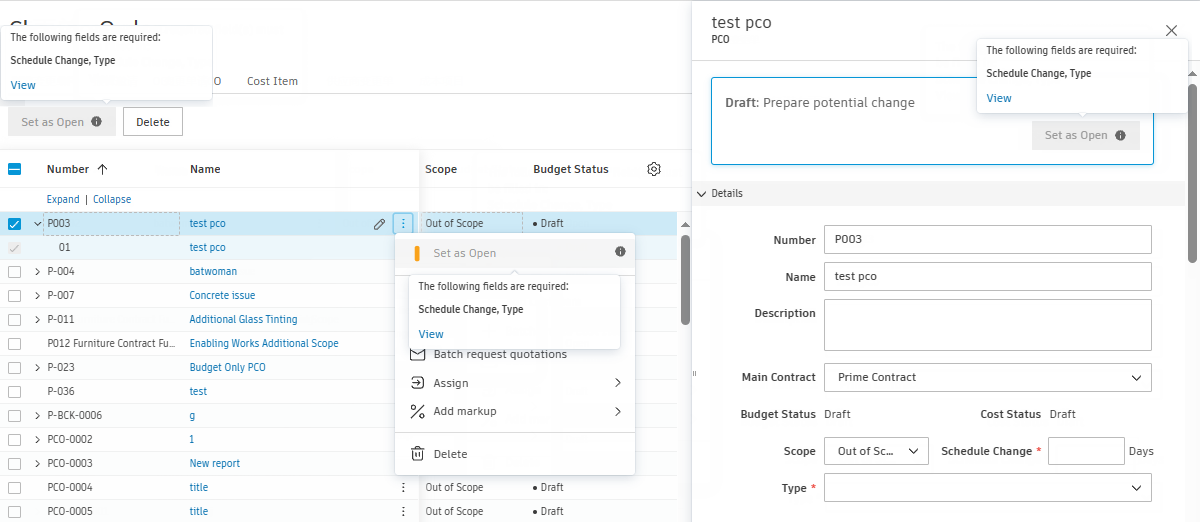

After setting it up, when changing the status of a change order, those fields are marked as obligatory and must be filled in to proceed with the change order workflow. By clicking View, you'll be redirected to the missing data.
Required fields validation message
Members with collaborative access also see the required fields when submitting an RFQ (Request for Quotation). See the Collaborative Potential Change Order Workflow article to learn how to collaborate with suppliers in Cost Management.
Required fields in collaborative workflow

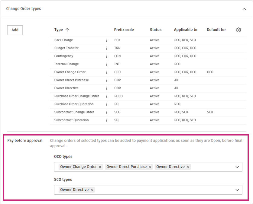

Change Order Types
Change order types can be used to filter your budget and contract tables and be part of your change order codes. You can deactivate the default types or add your own.
To add change order types:
  1. Select the Change Order tab from the Settings tool.
  2. Expand the Change Order Types section.
  3. Click Add.
  4. Enter the type name.
  5. Enter a description.

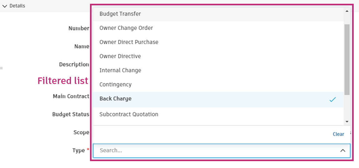

  6. Choose which change order module a type applies to. When you open the change order's flyout panel, you'll see this information displayed in the Type field as an option to choose for a particular change order.
    Change order type filtered list

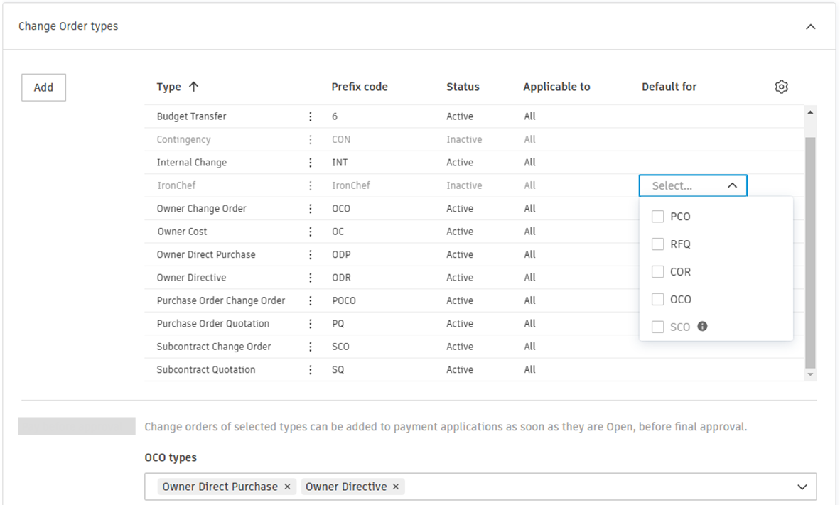

  7. Select whether a specific change order type should be set as the default option for a given change order. If a type is designated as the default for a change order, it will remain selected in the Applicable to section.
    Default change order type configuration
Select the More menu More menu icon to deactivate undesired default types.
Change Order Pay Before Approval
Administrators can select any OCO/SCO change order types to be manually added to Budget and Cost Payment Applications before these orders are approved. This allows for the change order value to be edited between payment applications.
To add change order types that can be included in payment applications when they have at least Open status, before final approval:
  3. Go to Pay before approval.
  4. Select the desired OCO and SCO types from the drop-down menu.
    Pay before approval settings
Tip: Learn how to add change orders in Budget Payment Application or Cost Payment Application.

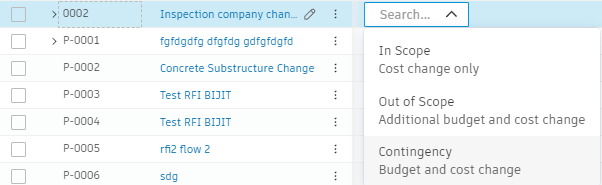

PCO and Cost Item Scope
Customise the name of the change order scope so that it can suit your company's needs.
To change the name:
  2. Expand the PCO and Cost Item Scope section.
  3. You can either add a customised name for the original scope or change its description.
Note: Description can't be left empty. If cleared, it will revert to the default.
In the example, Contingency is changed to Transfer:
PCO and cost item scope customisation

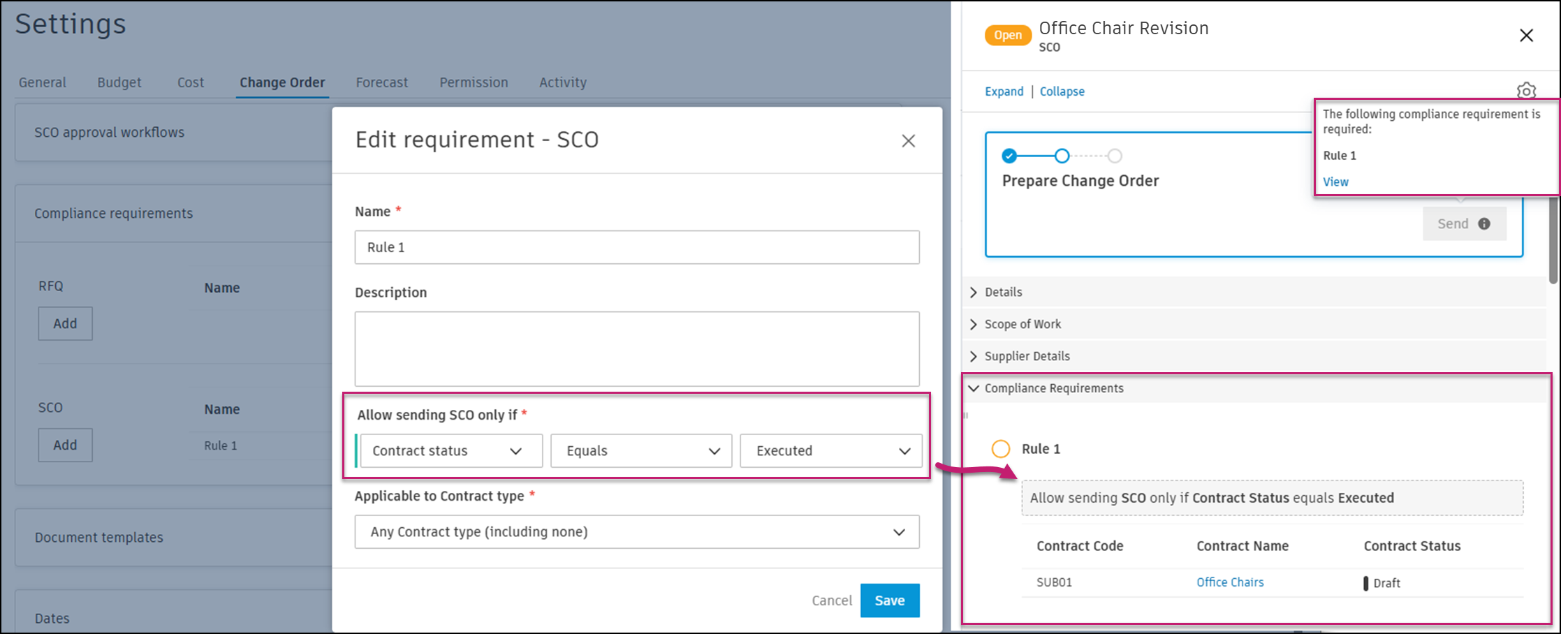

Compliance Requirements
Compliance requirements ensure that specific documents or conditions are met before change orders can be submitted or processed. You can set up different compliance requirements for RFQs (Requests for Quotation) and SCOs (Supplier Change Orders) to maintain project standards and regulatory compliance.
To define compliance requirements for change orders:
  1. Choose the Settings tool from the left navigation.
  3. Click on the Compliance Requirements drop-down list.
  4. You can add compliance requirements by clicking Add next to the desired change order type: RFQ or SCO. After clicking Add, the respective requirement window opens.
  5. Add the name and description of the requirement – those will be seen in the Compliance Requirements section in the change order details panel.
  6. In Requirements to submit RFQ or Requirements to send SCO, Requires a document is a default option. You can choose an extra option: Requires document expiry date. See the Set Up Expiry Dates for Compliance Requirements section in the Compliance Requirements article for more information.
Then, for RFQ:
  1. You can choose to which contract type the compliance should be applicable.
  2. If a compliance requirement is pending, project administrators can block RFQ actions. This option is useful when your workflow requires mandatory document submission before an RFQ or PCO as RFQ can be sent for review or approval. Only the general contractor or member with full control permission can override those compliance conditions. Once set to Allow RFQ actions, the compliance will be optional.
And for SCO:
  1. Set a condition on which the compliance will be based. For example, you can create a condition where you can't create Supplier Change Orders (SCOs) unless the contract is in an Executed status.
  2. You can choose to which contract type the compliance should be applicable.
Click Save when finished.
After adding a compliance requirement in the Settings tool, whenever compliance is not met during the workflow, you'll see a notification: The following compliance requirement is not fulfilled, followed by a list of unmet requirements.
Compliance requirement notification
See the Compliance Requirements article to learn how to work with these types of documents.
