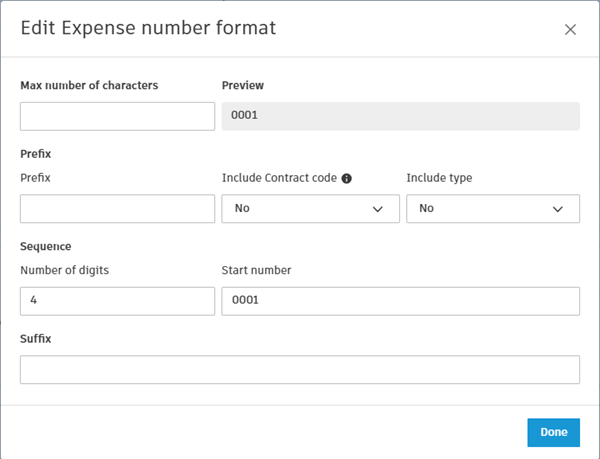

Define the Code Formats
Project administrators can control the default display of code formats within Cost Management.
To define the code format settings:
  1. Choose Settings from the left navigation.
  2. Switch to the Cost tab to define the expense code formats.
  3. Click the Number Format drop-down list.
  4. Select the More menu More menu icon next to Contract or Expense.
  5. Click Edit.
  6. For Contract, select Manual entry or Automatically generated.
    Note: If the contract code is automatically generated, format settings will be ignored. The contract code will be treated as a manual entry when created from ERP or imported from Excel.
  7. For each code type, define the following:
    • The maximum number of characters.
    • Prefix: anything before the generated numbers.
    • The number of digits and starting number. This sets how the numbers are automatically generated.
    • Suffix: anything after the generated numbers.
  8. Click Done.
Edit expense number format dialog

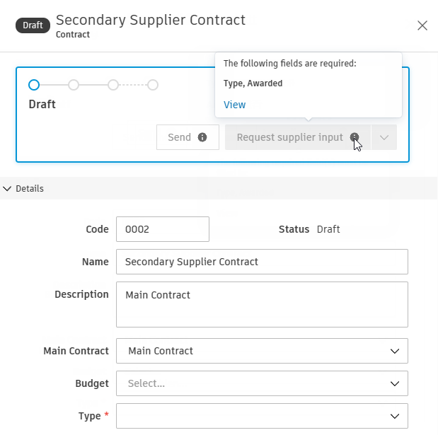

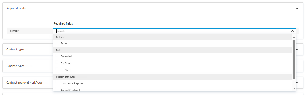

Required Fields for Contract
Project administrators can define a batch of fields as required when filling in data for a contract.
To do so:
  1. Open the Settings tool from the left navigation.
  2. Switch to the Cost tab.
  3. Scroll down to Required Fields and click it.
  4. Choose which fields should be marked as required. Custom attributes are also listed and can be chosen.
Required fields for contracts configuration
After setting it up, when creating a contract, those fields are marked as obligatory and must be completed to proceed with the contract workflow. By clicking View, you'll be redirected to the missing data.
Required fields validation message for contracts

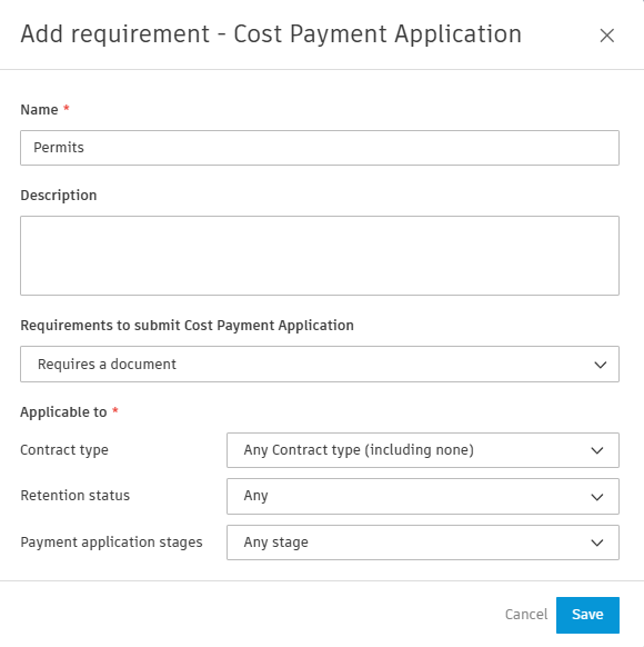

Compliance Requirements
Compliance requirements ensure that specific documents or conditions are met before contracts and cost payment applications can be submitted or processed. These requirements help maintain project standards and regulatory compliance, and ensure all necessary documentation is in place before proceeding with financial transactions.
To define compliance requirements for contracts and cost payment applications:
  1. Choose the Settings tool from the left navigation.
  3. Click on the Compliance Requirements drop-down list.
  4. You can add compliance requirements by clicking Add next to Contract or Cost Payment Application. After clicking Add, the respective requirement window opens.
  5. Add the name and description of the requirement. These will be seen in the Compliance Requirements section in the contract details panel.
  6. Then, follow the steps below depending on whether you're setting up compliance for contracts or cost payment applications:
For Contracts:
  1. Choose document-based or condition-based requirements:
    • For document-based: In Requirements to submit contract, Requires a document is a default option. You can choose an extra option Requires a document expiry date. See the Set Expiration Dates section in the Compliance Requirements article for more information.
    • For condition-based: Set a condition on which compliance will be based. For example, you can create a condition where you can't send a contract unless the Original Commitment is less than a Revised Budget.
      Note: If the requirement is non-compliant, you can choose to Block Contract Action or Allow Contract Action.
  2. You can choose if the requirement applies to one, several, none or all contract types.
  3. Click Save.
For Cost Payment Applications:
  1. Choose a document-based requirement. You can select an extra option Requires a document expiration date. See the Set Expiration Dates section in the Compliance Requirements article for more information.
  2. Specify applicability for this requirement:
    • Contract type: You can choose if the requirement applies to one, several, none or all contract types.
    • Retention release status: Choose between Any, Released and Not Released. Learn more about retention release.
    • Payment application status: Choose the applicable stage: Initial, Progress or Final. Learn more about payment applications' stages.
      You can create different sets of compliance for payment applications depending on the options you choose. A helpful note will appear, explaining how your choices affect the application. For example:
      Compliance payment note example
  3. Click Save.
After adding a compliance requirement in the Settings tool, whenever compliance is not met during the workflow, you'll see a notification: The following compliance requirement is required, followed by a list of unmet requirements. Here is the example:
Compliance requirement notification
See the Compliance Requirements article to learn how to work with these types of documents.
