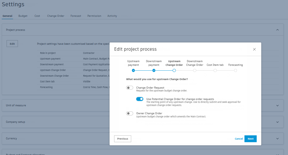

Project Process
This optional project process setting supports a straightforward setup process for different members. Based on the selected role and project preferences, you can configure which components display in Cost Management and apply appropriate permissions.
Project process setting
By using project process settings, the option to enable a collaborative Potential Change Order workflow is available. For more details on collaborative workflows and their impact on PCOs, see the Collaborative Potential Change Order Workflow article.
Owner Role Behaviour with Cost Change Workflow
When the primary user is assigned the Owner role in the project process setting, the system automatically applies specific behaviour changes to optimise the cost change workflow:
This automatic configuration maintains proper cost control and workflow alignment when projects are managed from an owner's perspective. For more information about owner workflows, see the Collaborative with Others in Cost Management article.
Caution: Keep only one contract per potential change order. More contracts in a PCO will generate an error.
Collaborative Potential Change Order (PCO) Workflow
The optional collaborative workflow for PCOs allows you to:
See the Collaborative Potential Change Order Workflow article to learn more.
Note: When "PCO as RFQ" is enabled, one PCO can only be associated with one contract for collaborative access to work.
Important: The collaborative PCO workflow can't be turned on for projects with existing change orders. A subscription to Autodesk Build is required to participate in the workflow. See Autodesk Build Pricing to learn more.

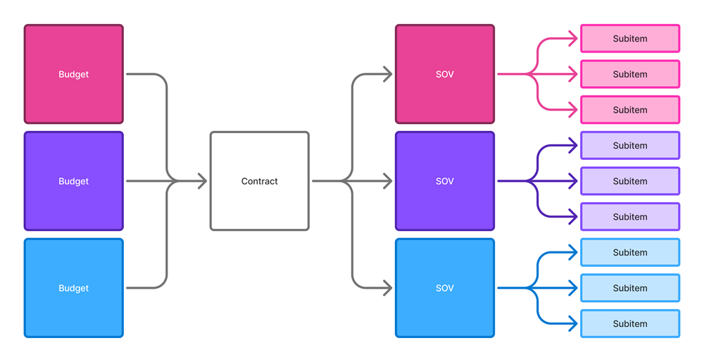

Budget and Contract Allocation
Members can add multiple budgets to a single contract by default. Here is the diagram that demonstrates the relationship between budget and contract allocations when this option is chosen:
Multiple Budgets to One Contract
Note:
For all diagrams presented in this section of the article:
  • Darker colours indicate items that are directly linked to the budget.
  • Lighter colours represent subitems of those directly linked items.
  • No background colour means there is no direct relationship with the budget.
Clicking Assign the same budget to multiple SOV items when the option of Multiple budgets to one contract is on helps when you need to organise your budget and contract items differently but want them to stay connected. It allows multiple contract items to link to the same budget item:
Assign the Same Budget to Multiple SOV Items

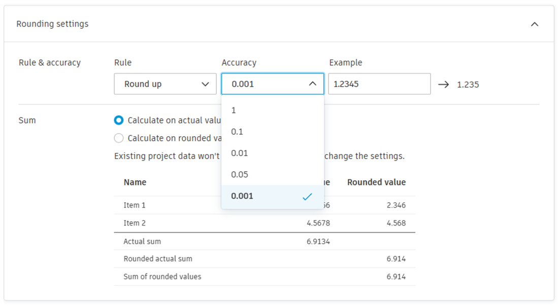

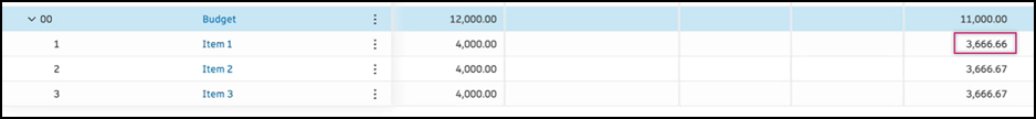

Rounding Settings
Use the rounding settings to provide the level of detail that you would like to see in Cost Management.
Rules:
You can set accuracy up to 0.001:
Accuracy setting
You can also define how the values should add up. You can calculate on:
Refer to the provided example to understand how those values will be recalculated in each scenario.
Existing project data won't be recalculated when you change the setting.
Note: When choosing Calculate on rounded values, each line item is rounded first, and then the total is calculated. If you enter a total at the summary level, the system will adjust a subitem to match the total.
Automated rounding example

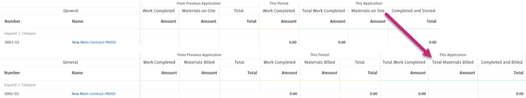

  3. Choose a method to calculate materials:
    • Materials Stored – Includes materials newly stored in the current period and previously stored materials not yet incorporated into the project.
    • Materials Billed – Includes both materials to be billed in the current period and materials previously billed. If Materials Billed is selected, a whole new set of columns will be added to both budget and cost payment applications, replacing the original Materials Stored columns.
Switch between options to see the difference in the payment applications’ columns.
Materials billed
The change in setting will also be visible in the flyout panel of the budget payment application in the Associated Costs section. The Materials Stored column changes to Materials Billed, and the new % column is added. You can also see the change in the Expense category in Associated Costs. If not visible, to see the new columns there, click the Gear icon icon and choose the necessary columns.

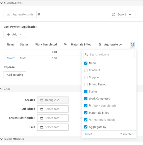

Associated costs
Tip: You can choose if Work Completed and Materials Billed should be aggregated by the amount or %. When aggregating costs by %, Work Completed and Materials Billed will be aggregated by their %. Materials Stored column will always be aggregated by amount.

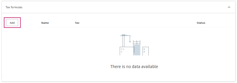

Tax Formulas
Use the custom tax calculation feature to calculate taxes in all cost processes and show tax in the generated cost documentation to comply with government requirements. Project administrators can add multiple tax formulas to control how taxes are applied for each contract, payment application and change order. Any existing formulas will be available in the list.
Create a Tax Formula

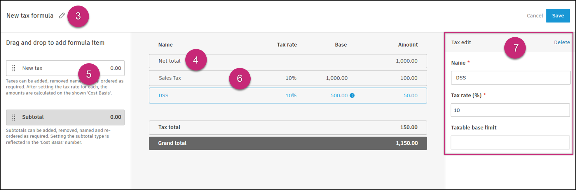

To create a tax formula:
  1. Within Cost Management, click Settings from the left navigation.
  2. On the General tab, click Tax Formulas and then Add.
    Cost settings tax formulas

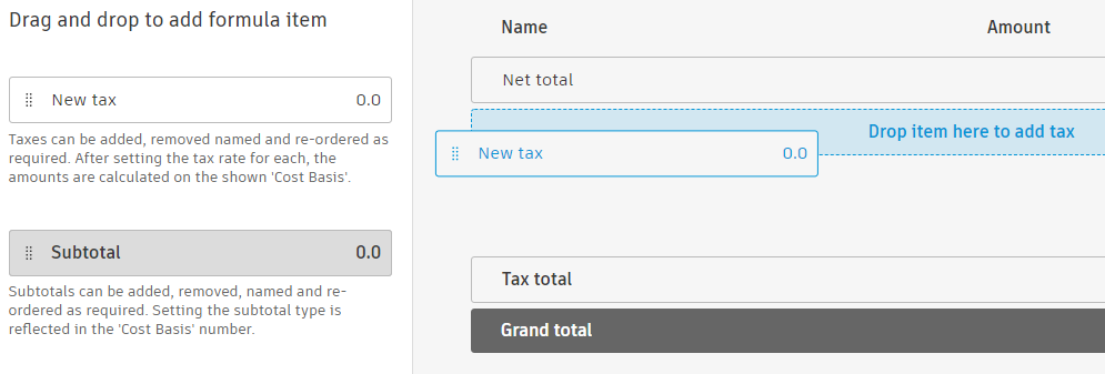

  3. Select the pencil icon to edit the formula's name.
  4. To update the net total default (1,000.00) in the centre preview panel, click Net Total.
  5. Drag a new tax into the centre column to add to the formula.
    Add new tax
  6. Click newly added New Tax to specify the Tax Rate as a percentage. The tax rate can be positive or negative. Negative tax rates are useful for figuring out CIS deductions.
    Edit new tax
    Important: If taxes in different tax formulas have the same name, they'll be combined into a single tax in the tax summary, regardless of the tax rate.
  7. Continue adding more taxes as needed to build out your formula. As you add taxes, the tax total is calculated based on the tax rate and the net total. Combined, these values produce the grand total. Taxes can be added, removed, named and reordered as required. After setting the tax rate for each, the amounts are calculated on the Cost Basis column.
    Note: You can add a taxable base limit. This limit determines the maximum amount of income that can be subject to taxation within a specific period.

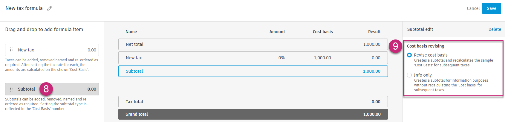

  8. Drag a new subtotal into the central column to add to the formula. The subtotal is used to support a tax-on-tax use case.
  9. On the right-hand panel, you can choose between two options:
    • Revise Cost Basis to recalculate the cost basis for subsequent taxes.
    • Info Only to have the subtotal visible for informational purposes without recalculating the cost basis for subsequent taxes.
    New subtotal
    Note: If there are multiple taxes above the subtotal, the subtotal will display both the tax subtotal and the subtotal.
  10. Click Save to save the tax formula.

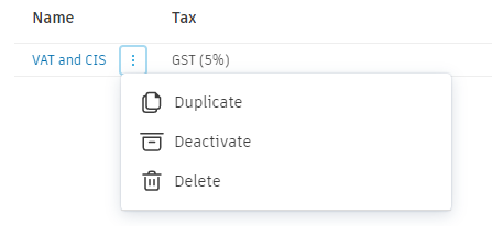

Edit and Manage Tax Formulas
After the tax formula has been created, you can use the More menu Vertical more menu icon to modify the formula by:
Cost tax formula more menu
Note: Tax formulas that have been applied to items can't be edited, deactivated or deleted.

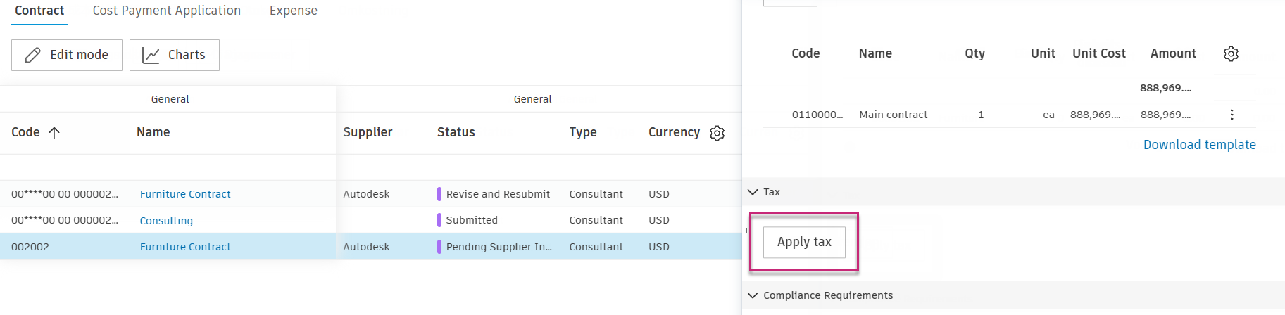

  3. Click on a line item's name to open the details panel.
  4. In the details panel on the right, scroll to the Tax section and click Apply Tax. If you only have one tax formula available, that formula is applied to the expense. If you have multiple tax formulas, select the formula to apply.
    Apply a tax details panel

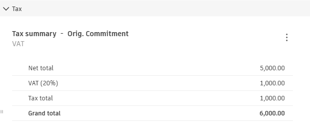

    The applied tax is visible in the tax summary for the line item.
    Tax summary details

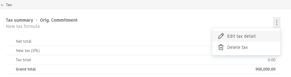

  5. If necessary, use the More menu Vertical more menu icon and choose Edit Tax Detail or Delete Tax.
    Cost tax more menu
    Editing the tax details allows you to turn on or off specific taxes as needed. The change is automatically updated in the Tax summary table.

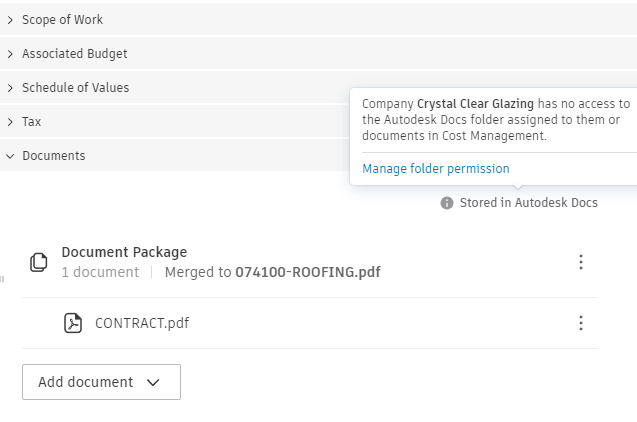

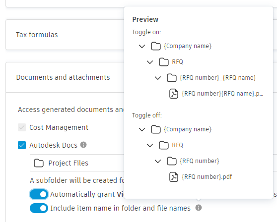

Documents and Attachments in Cost Management
You can choose to store documents and attachments in both Cost Management and a specified location in Autodesk Docs.
Documents and attachments will be stored in a subfolder created for each company when choosing the Autodesk Docs option. Choosing to store the files in Autodesk Docs creates a single repository of all generated documents specific to each company for future audit purposes. If desired, the folder can be shared with other project members to access the information. To do that, members must upload permission to the related folder to generate documents or upload attachments in Cost Management.
As a project administrator, you can automatically grant the Create permission to the assigned company. See the Folder Permissions article to learn how to manage folder permissions for each company.
In the Documents section, you can manage folder permissions for your company by accessing the flyout panel of the contract, main contract, payment applications and change orders. Simply click Manage Folder Permissions to open the relevant permissions for this company's folder.
Stored in Autodesk Docs
You can also include or exclude an item name in the folder and file names.
Shorten document name

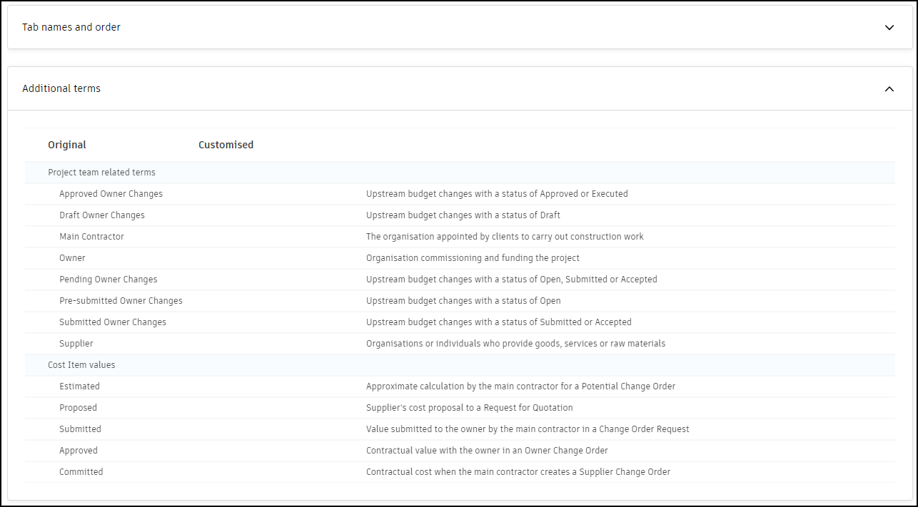

Additional Terms
As Owner or General Contractor, you can customise:
Additional terms customisation animation
Input your preferred terms into the Customised column. These terms will be automatically integrated and will appear in relevant areas across the entire Cost management.
Additional terms screenshot
