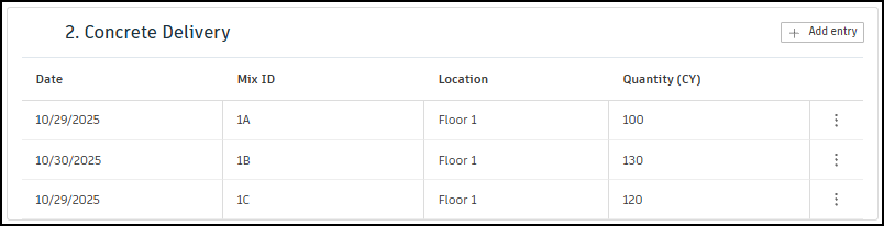

Use a table to:
Table section in form template. Example of a table section in a form template.

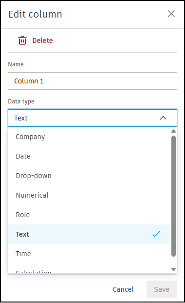

  1. Click a column header.
  2. In the panel that appears, you can:
    • Click Delete button. Button for deleting a column. to delete the column.
    • Edit the column name.
    • Select the data type for the column. Choose from:
      • Calculation: Lets you receive data from simple calculations on numerical or time fields in the same row. Learn more
      • Company: Form fillers select a company from the project's hub.
      • Date: Form fillers select a date from a calendar picker.
      • Dropdown: Form fillers select a value from a drop-down list.
        1. Enter the options for the drop-down.
        2. Click Add another option to add more options.
        3. Click the rubbish bin icon Rubbish bin icon. Rubbish bin icon for deleting options. to delete an option.
        (Optional) Turn on Allow free-form text responses to let form fillers enter their own values instead of selecting from the drop-down.
        Note: You can add up to 100 options in a drop-down column. Each option must be 50 characters or fewer.
      • Numerical: Form fillers can enter whole numbers or decimals. If they enter decimals, the value rounds to two decimal places. The value must be positive.
      • Role: Form fillers select a role from the project's hub.
      • Text: Form fillers can enter up to 200 characters.
      • Time: Form fillers select a time from a time picker.

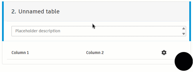

Edit multiple table columns in a form template
  1. Click the cog icon Cog icon in the top right of the table section.
  2. In the dialog, edit column names.
  3. To add columns, click Add column at the bottom of the dialog.
    Note: You can add up to 15 columns.
  4. To remove columns, click the rubbish bin icon Rubbish bin icon next to the column name.
    Note: You must have at least one column in the table.
  5. To reorder columns, hover over the column and hold the drag icon Drag icon to the left of the column name. Drag the column to the new location.
  6. Click Save.

  4. (Optional) Add a description for the table section in the Placeholder description field.
You can also add a description for the table section in the Placeholder description field.
