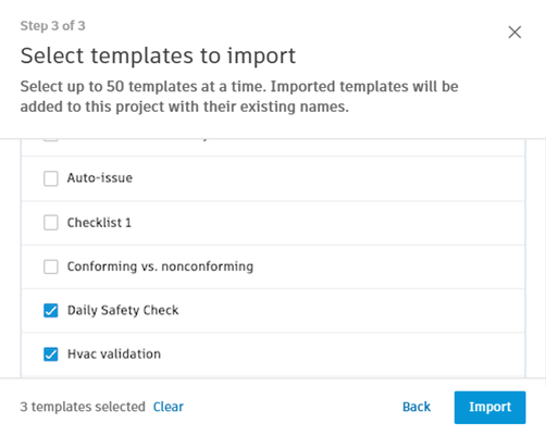

Select the templates that you want to import.
Note: You can import up to 50 templates from a single project at one time. Imported templates will be added to this project with their existing names, but you can edit them after they are imported.
Click Import and wait for the action to complete.
