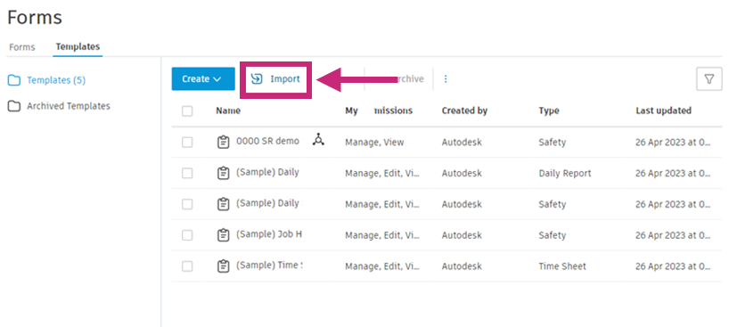

  1. Navigate to the Templates tab of the Forms tool
  2. Click Import

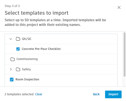

  5. Using the folder structure, select the templates you want to import
  6. Click Import and wait for the action to complete
  7. Click Import.
  8. Select Forma Build and click Next.
  9. Select the project or project template to import from and click Next.
  10. Select the templates that you want to import.
    Note: You can import up to 50 templates from a single project at one time. Imported templates will be added to this project with their existing names, but you can edit them after they are imported.
