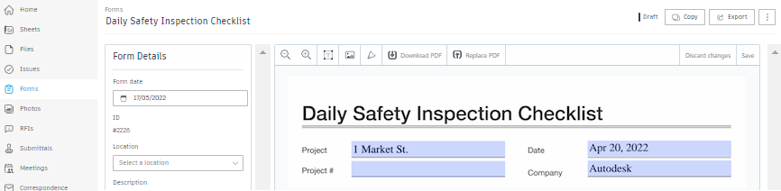

Use Smart Fields in Forms
In the Forms tool, you can upload a smart PDF to create a form template. In a smart PDF, fields can be set up to auto-populate with project information.
When set up, Forma Build can automatically grab and fill in information, such as project name or date, in the form. This makes it easier for your team to avoid more manual entry and quickly fill in forms.

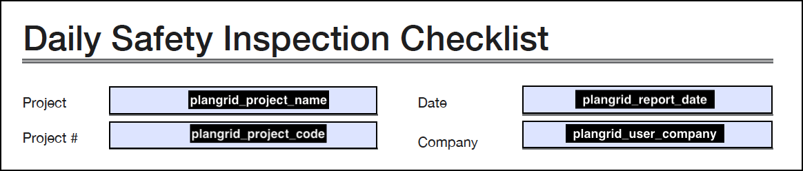

Create a smart field
In a PDF editor, edit a field's properties so that the ‘name’ field is one of the supported smart fields in the following list:
- ‘plangrid_project_name’ – The name of your current Build project.
- 'plangrid_report_date' - The date of the form.
- 'plangrid_user_full_name' - The full name of the current Build member.
- 'plangrid_user_company' - The company name of the current Build member.
- 'plangrid_project_code' - The Project Code listed in the project settings.
- 'plangrid_project_address' - The Project Address listed in the project settings.
- "plangrid_user_title" - The User Title listed in the Hub Settings of your hub.
- "plangrid_user_telephone" - The member phone number listed in the Hub Settings of your hub.
