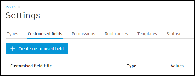

Create a Custom Field
  1. From the Custom fields tab, click Create custom field.
    Create custom field from tab

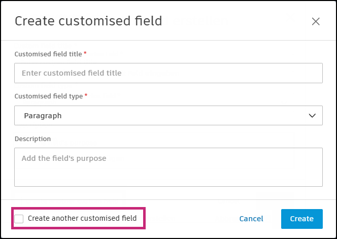

  2. Complete the required fields for your new custom field:
    • Customised field title
    • Customised field type
    You can also enter:
    • Description
  3. Select Create another custom field if you'd like to create another custom field immediately after this one.
  4. Once you have finished creating your custom fields, click Create.
Once you've created a custom field, it's available to select when creating a new category or type.

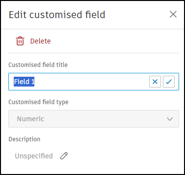

Edit and Delete Issue's Custom Fields
Once you've created a custom field, you're able to edit some of its details. Select the custom field you'd like to edit from the list in Custom fields.
You can edit the custom field title or description. Click on the field, enter the new title or description and then click on the tick box to save your changes.
Edit custom field
To delete a custom field, click on the delete icon.
Note: Customised fields can't be deleted if there are issues that reference them.
