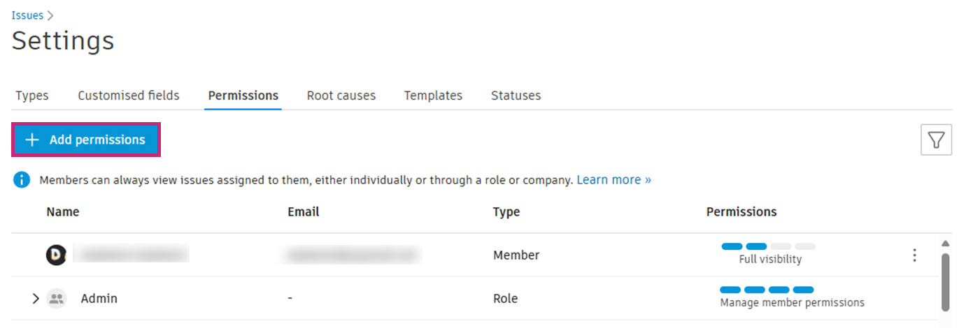

To assign someone a permission level in Issues, first add them to the Issues tool. Then, follow these steps:
  1. In the top right corner of the Issues Log, click Settings > Permissions.

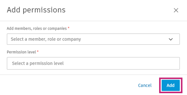

  2. Click Add permissions.
    Add member
  3. Select one or multiple project members, roles or companies and assign them a permission level, and click Add.
    Add member 2

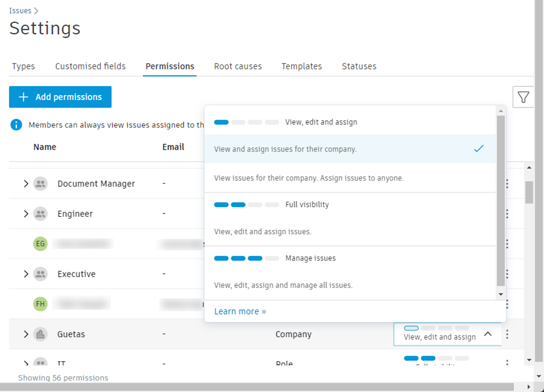

If you'd like to change the permission level for a member, role or company, find their role in the permission log and use the permission selection tool.
Change permission

Issue Permission Levels
Here is a quick summary of how the four permission levels can be used:
Tip: Click an expand icon next to the desired permission level to view the actions available to members with that permission.
View, Edit and Assign
The default permission level for all users unless a higher tier is specified. Members can view and edit issues for their company and assign issues to their company or members within their company. They can only view issues they created, issues assigned to them, issues assigned to their company, or issues they or their company are added as watchers on.
Members can view and edit issues for their company and assign issues to anyone. They can only view issues they created, issues assigned directly to their company, issues assigned to them or issues they or their company are added as watchers on.
