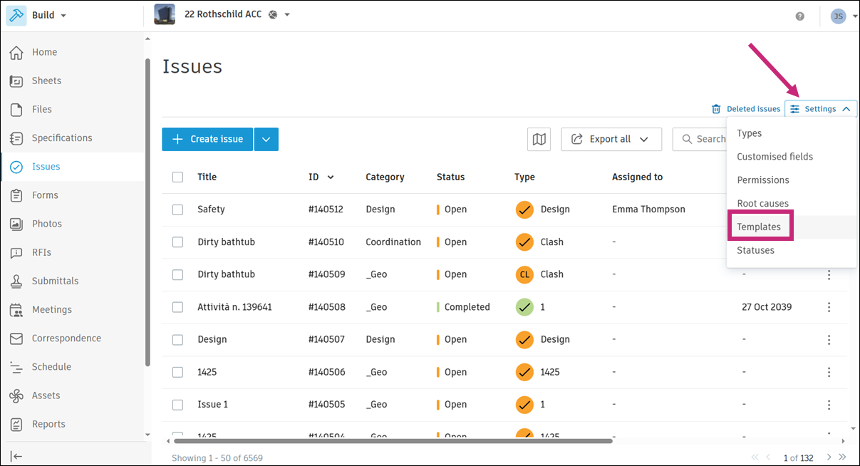

  1. Click Settings on the Issues log and choose Templates.
    Issues setting navigation

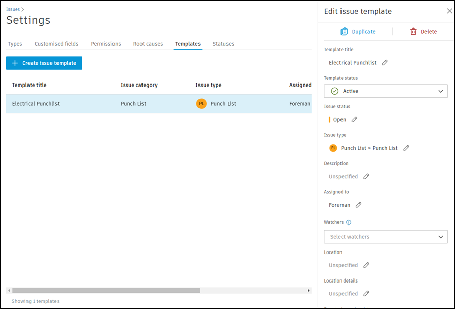

Edit an Issue Template
  1. From the Templates tab in Issues settings, click the relevant template.
  2. In the flyout panel that appears, edit any fields as desired.
    • Template status: Switching a template from 'Active' to 'Inactive' will make the template unavailable when creating issues. You can still view and edit the template in your issue settings.
