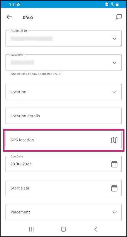

Add GPS Locations to Issues on Android
You can add a GPS location when creating or editing an issue.
  1. In the Autodesk Construction Cloud mobile app, navigate to the Issues tool.
  2. Tap on an existing issue or create an issue.
  3. Tap on the GPS location field.
  4. Allow the app to use your location. Select from While using this app, Only this time or Don't allow.
    a. If you allow the app to use your location, you will be directed to place an issue pin on the map. The map that appears is based on your current location. Move the map to the desired location and tap Done to place the issue.
    b. If you don't allow the app to use your location, you will be directed to place an issue pin on the map. The map that appears is based on your project's location. Move the map to the desired location and tap the map to place the issue.
    You will be asked if you would like to change your settings for next time. We do suggest granting access to your location to quickly add GPS coordinates to your issues. Click Change setting or No, thanks.
    Learn more about managing your Android device's location settings.

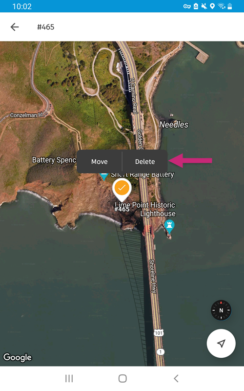

Edit and Remove GPS Locations on Issues on Android
  1. In the Autodesk Construction Cloud mobile app, tap on an issue in the Issues tool.
  2. In the issue's details:
    a. Tap on the thumbnail map.
    b. Tap the issue pin, and then tap Move or Delete in the menu.
    i. Move: Hold and drag the issue map to a new location. Tap to place the pin.
    ii. Delete: In the pop-up, tap Delete.
