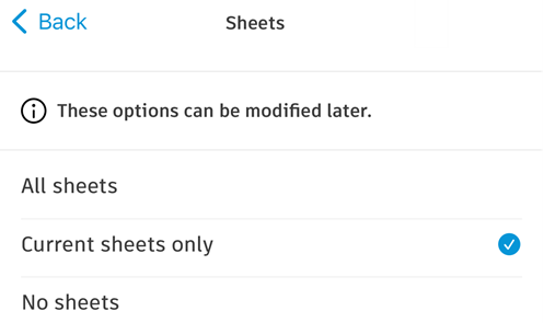

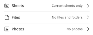

    • Sheets: (Forma Build only)
      • Current sheets only: Download only the current set of sheets, for example to get ready for your site walk
      • All sheets: Download all versions of all sheets
      • No sheets
    • Files:
      • All files and folders
      • No files
        Note: File download options are available only the first time you download each project to your device.
    • Forms: (Forma Build only)
      • All forms
      • Active forms only (In progress and In review)
        Note: Forms download options are available only the first time you download each project to your device.
    • Photos: (Forma Build only)
      • All photos
      • Only photos created in the last 7, 14, 30 or 60 days
      • No photos

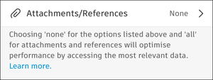

  4. Tap Attachments/References:
    Attachments/References options
    Attachments and References are references added to project items. For example, a photo may be referenced on an issue to provide more context. You can decide which attachments and references to download to your device.
    • Select all: Toggle on to download all attachments and references as detailed below.
    • Issues: Toggle on to download attachments and references for all active issues (all issue statuses except Closed).
    • Forms: Toggle on to download all attachments and references for all active forms (in progress and in review).
    • RFIs: Toggle on to download all Official Response Attachments for all RFIs.
    • Submittals: Toggle on to download all Official Response Attachments for all submittals.
      Note: Some items, such as sheets or photos, can be both individual data and attached to or referenced by another item. Therefore, two sets of download options might apply. All items that meet each set of criteria are downloaded.

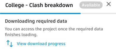

  6. Tap Download to device. You can view the progress as your project downloads.
    Downloading project

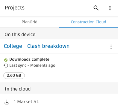

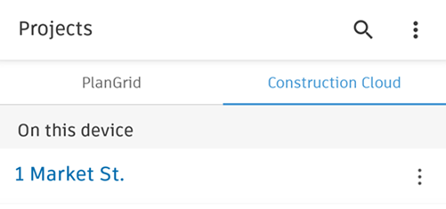

Your project moves to the On this device section when it is downloaded.
Project on device
