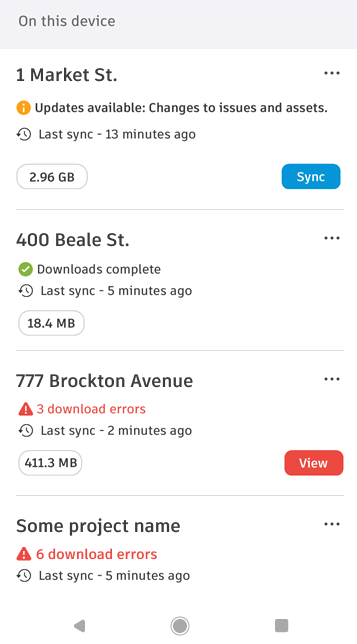

  1. Tap the More menu More menu icon for iOS to the right of a downloaded project.
  2. Tap Edit Download Options.
  3. Change what you want to download to your device.
    Note: The Files download option cannot be edited. You can change the download settings for individual files and folders in the Files tool anytime after the initial download. Learn more.
  4. Tap Apply changes.
Edit Project Download Options (Android)
  1. Tap the More menu More menu icon for Android to the right of a downloaded project.
The new download options will be active from the next project sync – for example if you choose to sync the project after being notified of project updates, or if you refresh a project at any time.
