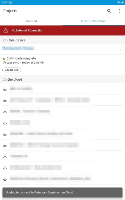

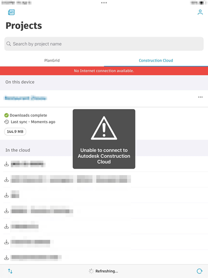

  1. If you see banners and messages stating ‘No internet connection available’ or ‘Unable to connect to Autodesk Forma’, the device is disconnected from Wi-Fi.
    Toggle Wi-Fi off and on. Test your connection by searching in the mobile browser. If you can't search, you don't have internet.
