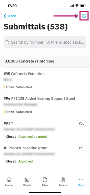

What does this sync button control?
The new in-project sync button initiates fetching updated project data from the cloud and downloading it to the device.
In-Project Sync Button
The uploading of data is an automatic, seamless experience today and we're not changing it. The app will automatically upload changes made on mobile devices to the cloud whenever there's connection.
