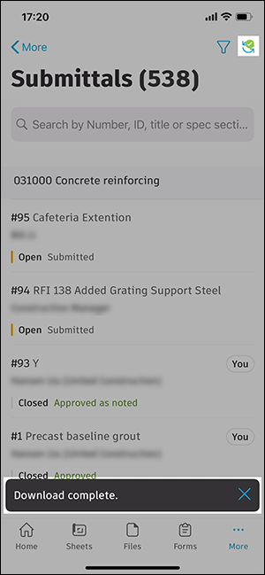

What does this sync button control?
The new in-project sync button initiates fetching updated project data from the cloud and downloading it to the device.
In-Project Sync Button
The uploading of data is an automatic, seamless experience today and we're not changing it. The app will automatically upload changes made on mobile devices to the cloud whenever there's connection.

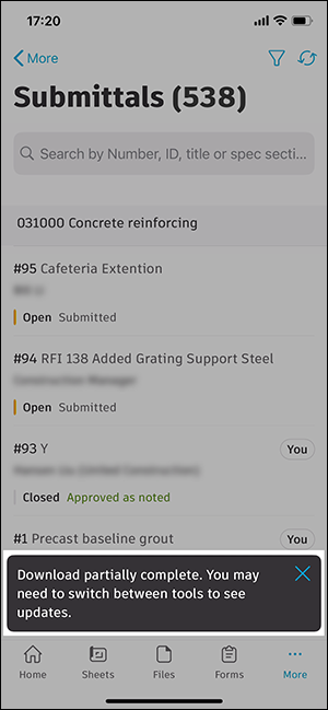

What happens to sync errors? How do we handle them?
Sync errors will be handled in the same way as they are when you sync a project from the Projects list. The list of errors is in the app's Sync Status tool. Learn more.
Download errors do not block you from working. You can ignore the download errors or try to resync later.
