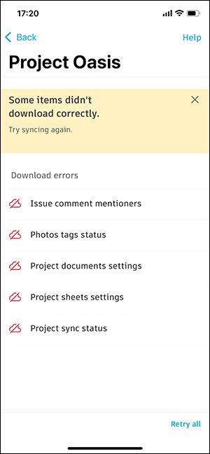

In-project sync errors
After the partial and full download, you may be notified that the download was complete with errors. The sync icon will have a red dot on it.
To troubleshoot in-project sync errors:
Clicking View errors will take you to the Downloads tab in the Sync Status tool. Review the errors to resolve as needed.
