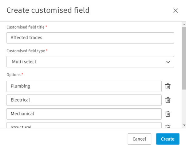

Click Create custom field.
Enter a title for the custom field.
Select a custom field type. Available types include:
Date: Allows someone to enter a date value for the field.
Multi-select: Allows someone to select multiple, preset values for the field.
Numeric: Allows someone to input a numeric value for the field.
Single-select: Allows someone to select a single, preset value for the field.
Text: Allows someone to enter a text value for the field.
If you selected the multi-select or single-select field types, define the options for someone to select.
Add a description if needed and click Create.
