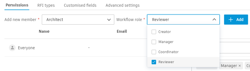

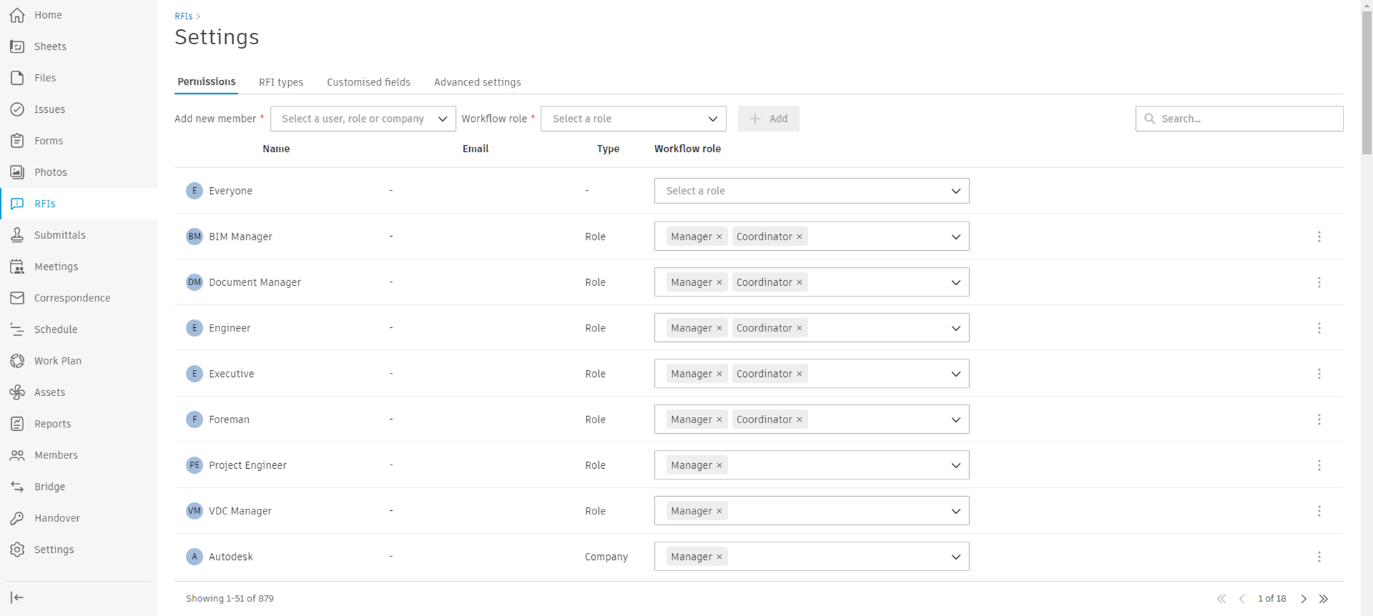

To set permission levels:
  1. Click RFIs from the left navigation to open the RFIs tool.
  2. Click Settings menu and choose Permissions.
  3. Select a member, role or company from the drop-down menu and choose a permission level. Available permission levels include:
    • Creator
    • Manager
    • Coordinator
    • Reviewer
  4. Click + Add.
Note: You can assign members, roles and companies to permission levels in project templates. However, roles and companies cannot currently be assigned as managers or reviewers in the RFI workflow.
