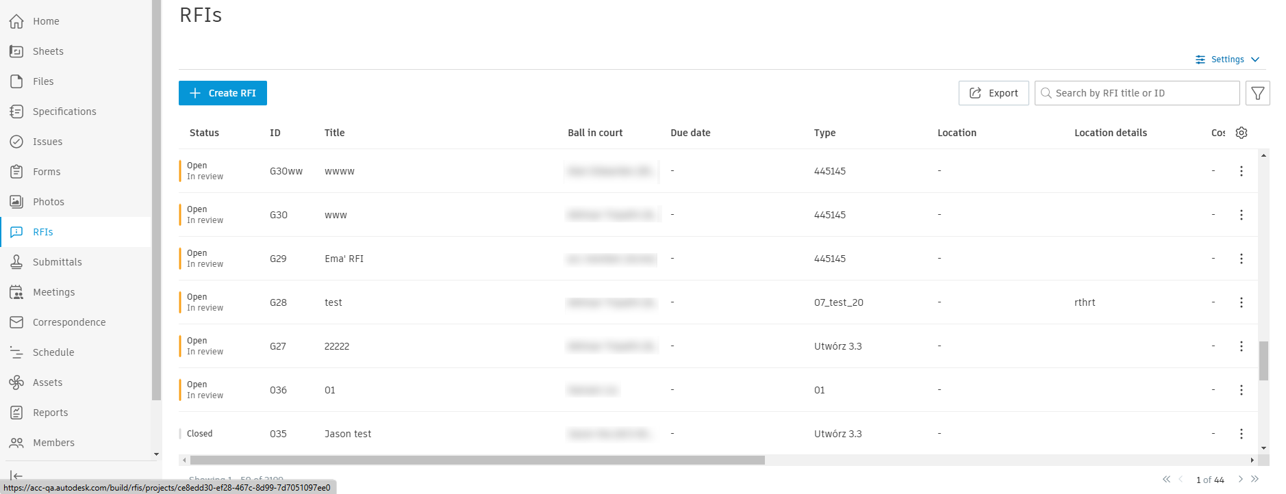

What is the RFI Tool?
A Request for Information (RFI) is a formal process used to obtain clarification or additional information from architects, engineers, clients or other stakeholders involved in a construction project. The RFI tool in Forma Build helps teams manage these requests efficiently, ensuring work proceeds according to project specifications and plans. The tool is available both through web browsers and mobile devices.

Forma Build supports two different RFI workflows to accommodate different project needs:
Default RFI Workflow
The default workflow provides a straightforward path for information requests and responses:
  1. Creation & Submission
    • Creator prepares the RFI with relevant questions and references
    • Once complete, Creator submits to the RFI Manager
  2. Manager Review
    • Manager receives the RFI and evaluates the request
    • Can assign up to 10 reviewers based on expertise needed
    • Changes status to ‘Open’ to initiate review process
  3. Review & Response
    • Assigned reviewers provide their expertise and responses
    • Responses are tracked separately for each reviewer
    • Manager can indicate if certain reviewers should be skipped
  4. Official Response & Closure
    • Manager reviews all responses
    • Selects or composes the official response
    • Distributes the completed RFI to project team
Enhanced Workflow with Coordinator
This workflow adds a coordination layer for more complex projects:
  1. Initial Steps
    • Creator submits RFI
    • Manager receives and assigns to Coordinator
  2. Coordinator Review
    • Coordinator conducts preliminary review
    • Can provide early feedback or clarification
    • Routes RFI to appropriate reviewers
  3. Expert Review
    • Selected reviewers conduct detailed assessment
    • Provide specialised input and recommendations
  4. Response Coordination
    • Coordinator synthesises reviewer feedback
    • Can provide official response or return to Manager
    • Ensures consistent communication approach
  5. Closure
    • Manager reviews final response
    • Distributes to project team
    • Creates permanent record
