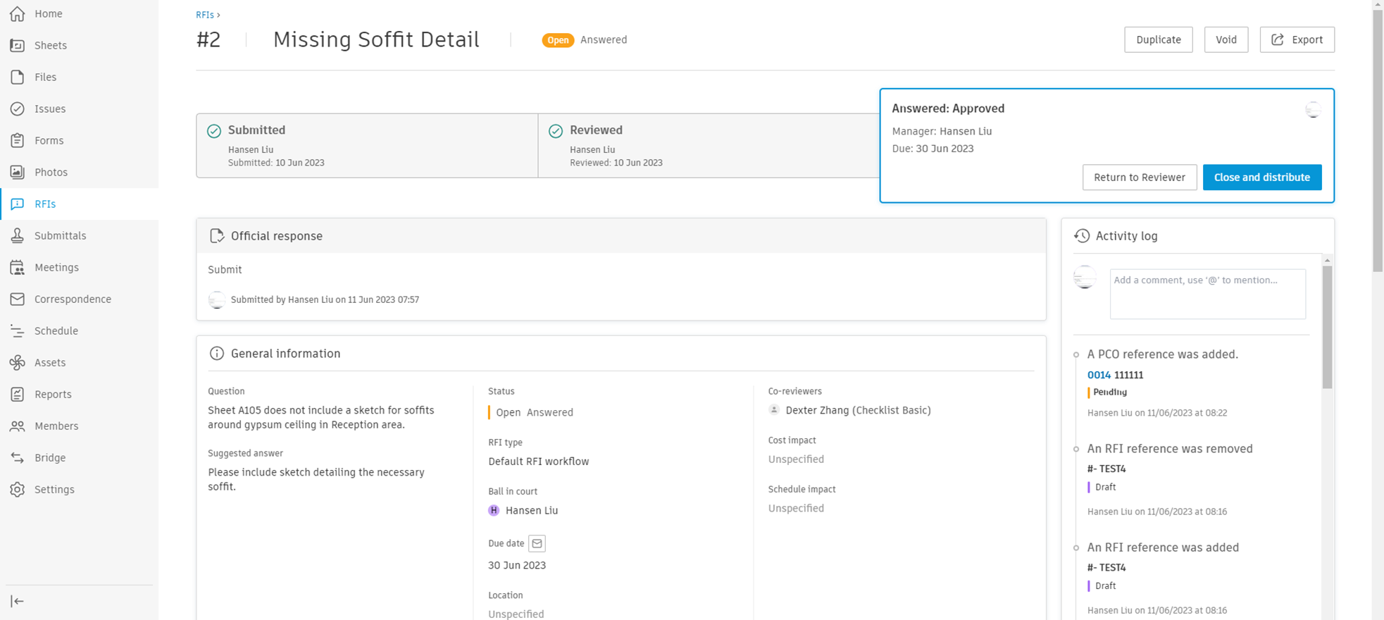

The Activity Log is an essential feature of the RFIs tool, offering a comprehensive record of all activities associated with a Request for Information (RFI). It provides a chronological account of all interactions, including status changes, responses, document uploads, edits, and other related activities.
In addition to tracking status changes and other significant actions, the activity log of an RFIs tool also facilitates communication among project participants through the use of comments. This interactive feature enables you to add contextual notes, ask questions or provide additional information directly within the log.
Close and Distribute RFI in the following scenarios:
Workflow with reviewers only: In this case, the Close and Distribute wizard is always used by the RFI Manager when closing the RFI.
Workflow with a coordinator: The Close and Distribute wizard is used by the RFI Manager only when the Edit Official Response advanced setting is enabled, enabling managers to edit the Coordinator's official response.
Closing and Distributing consists of two steps:
Step 1:
The left side of the wizard displays the previous responses provided by reviewers. The RFI Manager can select one or more responses to be included in the official response.
The right side shows the official response that will be submitted. If the RFI Manager has permission to edit the official response (based on the Edit Official Response advanced setting), they will have the option to add attachments to the response or remove previously added attachments.
Step 2:
The left side provides a non-editable preview of the official response that will be distributed, including any attachments.
The right side focuses on distribution settings, such as selecting watchers, adding comments and choosing whether to save the RFI detail report in a project folder.

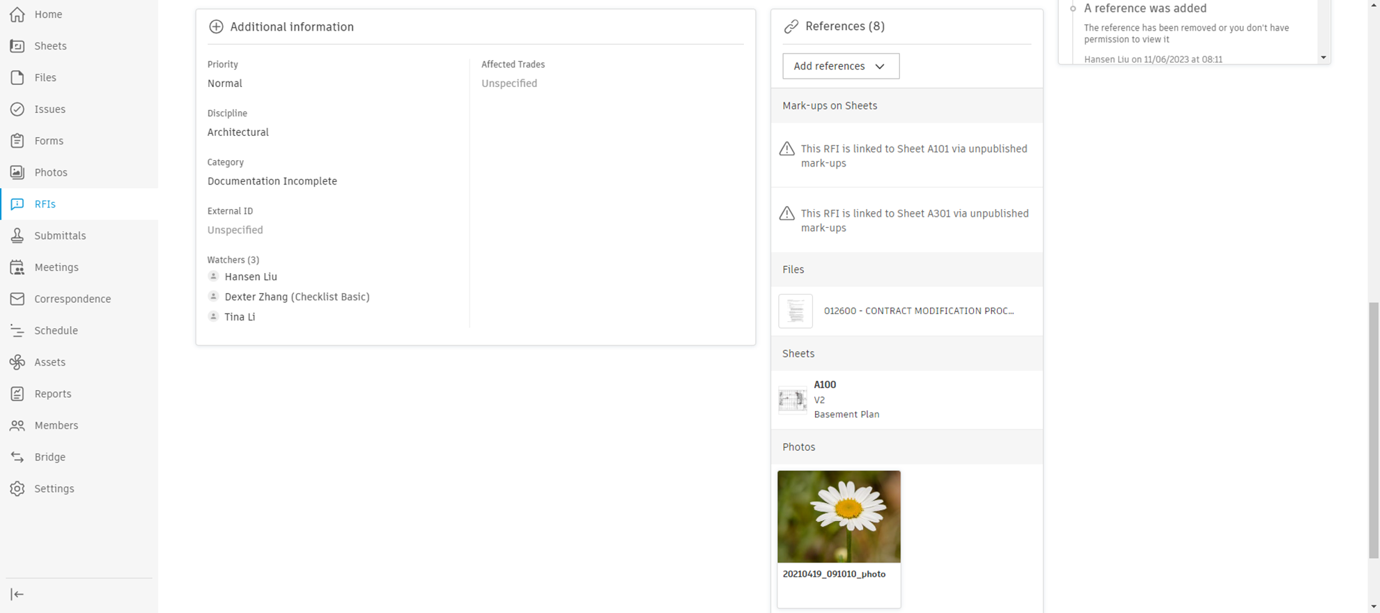

The Additional Information section of the RFIs tool is designed to provide extra flexibility and customisation to better cater to the specific needs of a project or organisation. This section contains all the custom RFI fields that you can define based on your unique project requirements.
Custom fields enable you to capture and store data that may not be accommodated by the standard fields in the RFI form. These could include fields for specific codes, identifiers, categories or any other data relevant to your project's RFIs.
Note: Custom fields can be filled out upon creation of RFI item or later on RFI item's page.
In essence, the Additional Information section enhances the RFIs tool's capacity to capture, store and report all the information needed for effective project management.
The References feature in an RFIs tool significantly enhances the clarity and comprehensiveness of a RFI. This feature allows you to link or reference various types of relevant content directly to an RFI. This can include:
Files and Sheets: These can include relevant documents, drawings or spreadsheets that provide necessary context or details for the RFI.
Photos: Images can offer visual clarification, helping to illustrate the issue or question at hand.
Submittals: Reference to submittals can help link the RFI to specific materials, products or equipment related to the project.
Spec Sections: Reference to specific spec sections provides direct links to relevant technical requirements or standards applicable to the RFI.
Issues: Referencing related issues can provide additional context and show how the RFI ties into broader project challenges or concerns.
Other RFIs: Sometimes, RFIs are interconnected. Referencing other RFIs can help avoid redundancy and ensure all related queries are addressed collectively.
Schedule: Linking to the project schedule can underline the RFI's impact on project timelines or highlight dependencies.
Assets: References to specific assets (like equipment or facilities) can be crucial when the RFI pertains to these elements.
Potential Change Orders (PCO): RFIs often lead to changes in the project. Referencing potential change orders can help track these changes and their implications.
Forms: Forms associated with the RFI, such as inspection forms or checklists, can be attached as references.
References can be added upon creation of RFI item or later on RFI item's page. To add reference to RFI item:
Click Add references button in References section.
Select the type of reference.
Select one or more references.
Click the Add button.
