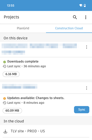

Sync and Update Sheets on Mobile
You can choose to automatically sync updates from the web and download them to your device with the Background sync setting. See the Background sync help topic for requirements and more details.
If background sync is not turned on, the following actions on web will result in updates to sheets you can sync to your device:
Note: Changes to markups or issues on a sheet on web will not trigger this message.
When an update is available, a Sheets updates available message will be displayed in the Sheets tool.
Tap the message and tap Sync to update the project.
You can also update sheets from the projects list. If there are updates available, an Updates available: Changes to sheets message is displayed under the relevant project in the projects list. Tap Sync to update.

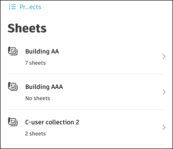

Collections on Mobile
You may have construction projects with multiple buildings and need to use the same sheet numbers (for example, A101, A102) for two or more buildings. Collections enables you to organise their sheets into collections so they can be uploaded to the Sheets tool on web without versioning on top of each other.
Members can use collections on mobile after these steps are completed in the following order:
  1. A project administrators has enabled collections in the relevant project on web.
  2. Collections have been created on web.
  3. Members have updated the Autodesk Forma mobile app to the latest version.
Once the above steps are completed, you are ready to use collections on mobile:
  1. Open your collections-enabled project on the Autodesk Forma mobile app.
  2. Tap Sheets tool.
    Your sheets are organised by collection and sorted in alphabetical order.
  3. Tap the relevant collection to view its sheets.

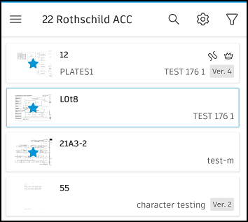

Add and View Favourite Sheets on Mobile
You can add commonly used sheets to your favourites to display them at the top of your sheets list for easy access.
  1. Tap the relevant sheet.
    • Android: Tap the More menu at the top right
    • iOS: Tap
  2. Tap Add to favourites.
When you access your sheets list or grid, your favourites will be marked with a star and listed at the top.

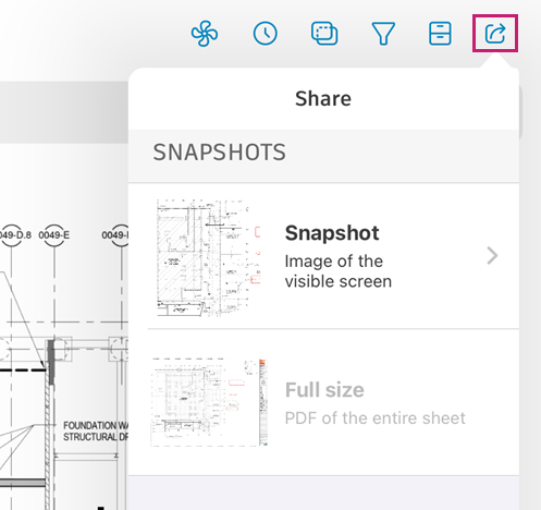

Share Sheets on Mobile
Members can share a snapshot of a sheet, or a full-size PDF of the entire sheet. This can be useful if you want to share a sheet comparison or a sheet with markups with other members.
  1. Tap the relevant sheet:
    • Android: Tap the More menu at the top right and tap Export.
    • iOS: Tap the following icon:
  2. Select either a snapshot of the visible screen, or a full-size PDF of the entire sheet.
  3. Tap the desired thumbnail to view the following share options:
    • Email.
    • Open in: Full size only. This allows you to share using other apps.

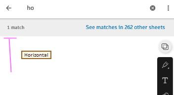

Search Sheets on Mobile
You can search your entire sheet list for sheet number, title and in-the-sheet content. You can also search for content in a sheet you've opened in the viewer.
Search the sheets list
In the sheet list, enter the text you want to find in the search box. The results are split into two tabs:
Search sheets in the viewer
Tap the relevant sheet and enter the text you want to find in the search box.
The search results will automatically display the number of matches returned. All search matches are outlined in brown. You can also tap the link for any search matches made in your other sheets.

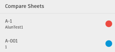

Compare Sheets on Mobile
  1. Tap the Sheets icon .
  2. Tap one of the sheets to compare:
    • Android: Tap
    • iOS: Tap
  3. In the Compare Sheets dialog box, select the second sheet.
    The sheets are overlaid on top of each other and you can toggle between the differences shown in red and blue.
Align Sheet Comparison on Mobile
The compared sheets may not always be aligned. To adjust the alignment while comparing the sheets:
  1. Drag the sheet to align it with the other sheet.
  2. Tap the tick.

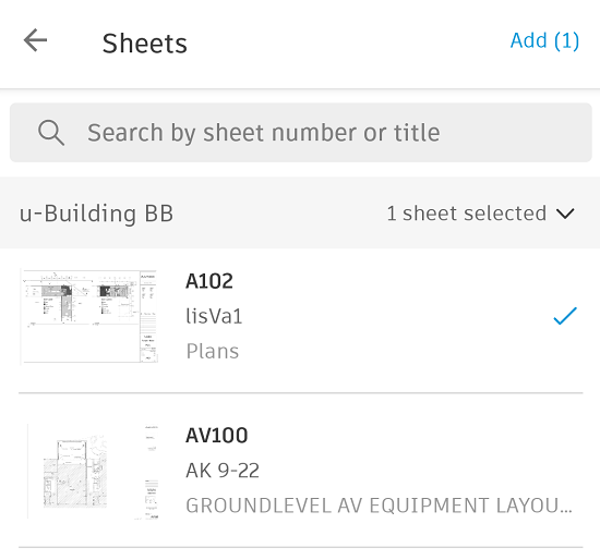

Sheets References
You can add sheet references to items in other tools on mobile to provide supporting information or extra detail. For example, you can add a sheet reference to an RFI.
  1. Tap the relevant tool (for example, the RFI tool).
  2. Select the relevant item or create a new item.
  3. In the References section, tap + Add next to Sheets
  4. Search for the relevant sheet, or select a collection that contains your sheet.
  5. Select your sheet or sheets.
  6. Tap Add(x) at the top right.
    The referenced sheets will be displayed under the References section in the relevant item.
