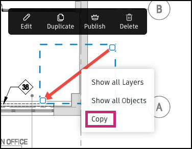

  2. To copy, you can right-click or use keyboard shortcuts.
    • Right-click one or more markups and click Copy.
    • Keyboard shortcuts: Press Ctrl + C or CMD + C.
