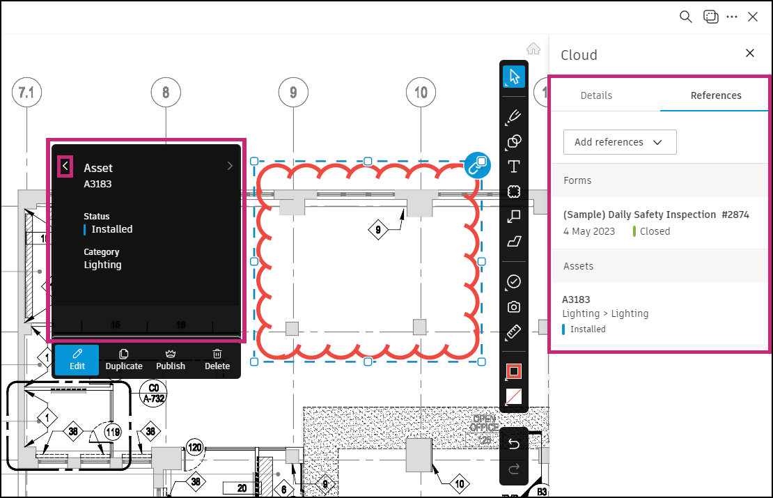

In the right panel, click the References tab.

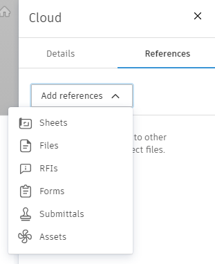

Click Add references and choose a reference type. Options include:
References will be listed in the References tab. Also when you click a mark-up, in the menu, you can quickly see the references and if applicable, use the arrows to navigate between multiple.

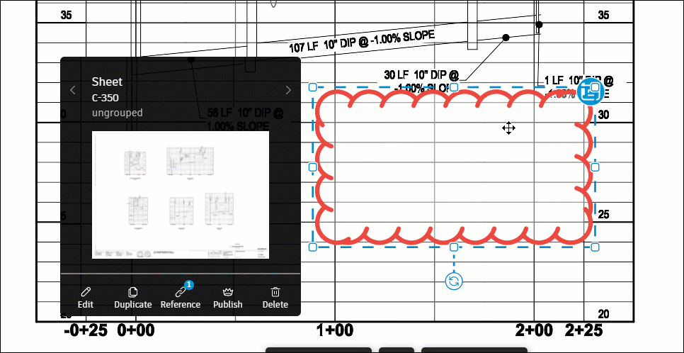

With a markup selected, you can drag a reference badge to move it anywhere in the viewer. This won't affect anyone else's view of the badge, and the move only lasts as long as your current file viewing session.

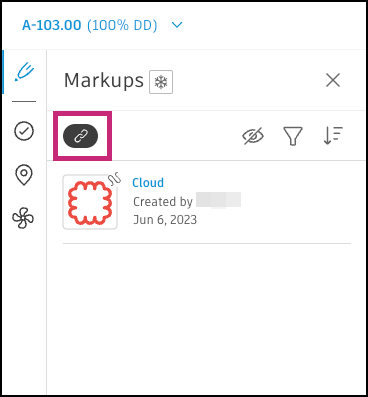

In the left navigation menu, click the markups icon
Click the badge icon.
Hiding reference badges won't affect anyone else's view and only lasts as long as your current file viewing session.
