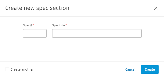

Note: You can create new spec sections in your project simply by including them in the Excel spreadsheet during the Import process.
  1. Open the Spec sections tab.
  2. Click Create spec section.
  3. Enter Spec # (number).
  4. Enter Spec title.
Tip: When creating multiple submittal spec sections, tick Create another to open a new Create new spec section window once you click Create.
Once created, spec sections can be edited or deleted as needed.
