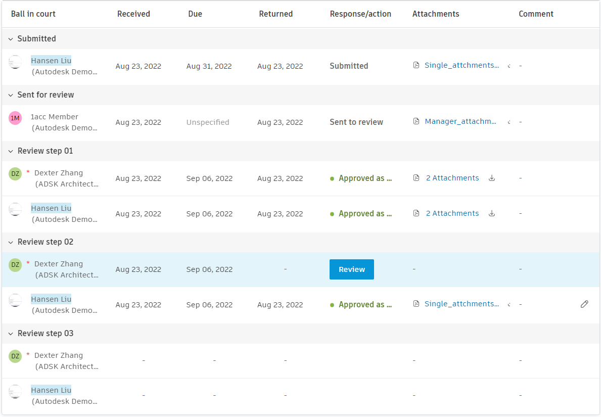

Reviewers review the items and can see the current status of all reviewers in the workflow table. The review interface provides enhanced visibility into the review process:
Review Status Display
Pending Reviewers: The workflow clearly shows which reviewers haven't responded yet in the current step
Completed Reviews: Previously submitted responses are visible with timestamps and reviewer information
Review Order: Required reviewers are prioritised and clearly marked, followed by optional reviewers
Response Chronology: All responses are displayed chronologically to provide a complete review history
Note: The window displays the current reviewer's section expanded by default when they are setting a response, while showing collapsed sections for other reviewers who have already responded or haven't started their review.
