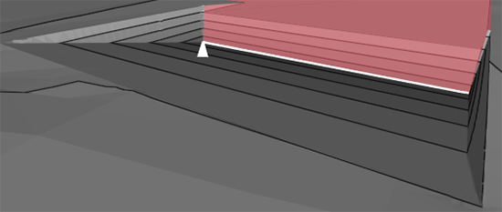

Reveal grading objects control the desired visibility of a building pad from the terrain surface to the top of the pad. You can only apply a Reveal to existing building pad objects. Use Reveals to specify locations for common building elements such as loading docks, steps, stairways and entryways.

Note: You can set independent elevations for each end of the Reveal. The Reveal will show an arrow in Grading Optimization, representing its start and end points.

In your drawing, Reveals appear as bold lines with grips when the building pad is selected. Use the grips to make adjustments.
Note: Click the red X next to the reveal to remove it from the drawing.
